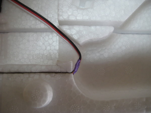

On the other fuselage half, a hole for the output servos must be cut. Here the rudder servo wire can be seen passing by. The wire is embedded in the foam, so as not to interfere with the underside of the board, and then appears through the newly cut gap. When installing the APM, that wire is going to get pushed back into the compartment behind.
