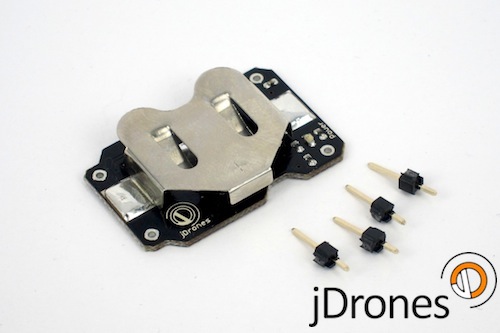

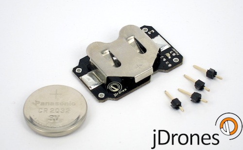

Just to let you know, jD-MediaTEK backup battery trays have now arrived.
Here are first pictures of those for you all. Close up of battery tray.
As said earlier this tray can accommodate CR2032 battery that will last about 8-12 months according manufacturers information.

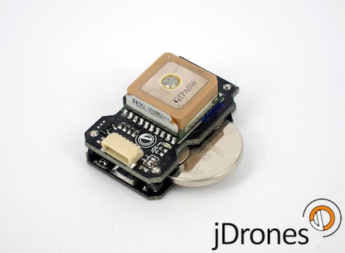

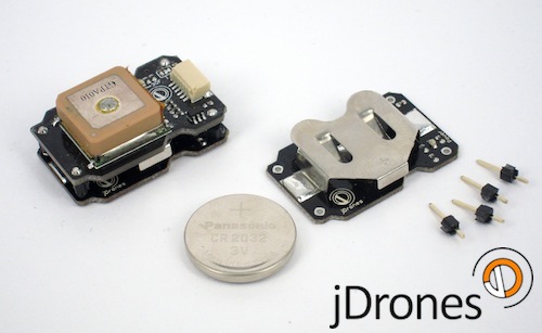

After you have connected everything together your GPS packet should look like this on top/left corner
Changing battery is really easy. Just push it out from other side and pull it out. Best way to push it is with plastic liner or something else less than 2mm thick non metal item.
We have tested a lot this combination, usually 3D lock times are between 2-5 seconds after power-up of GPS unit. We did even test it on inside our office building where normally we won't get any lock at all.. Now we can get lock in 10-15 seconds.
