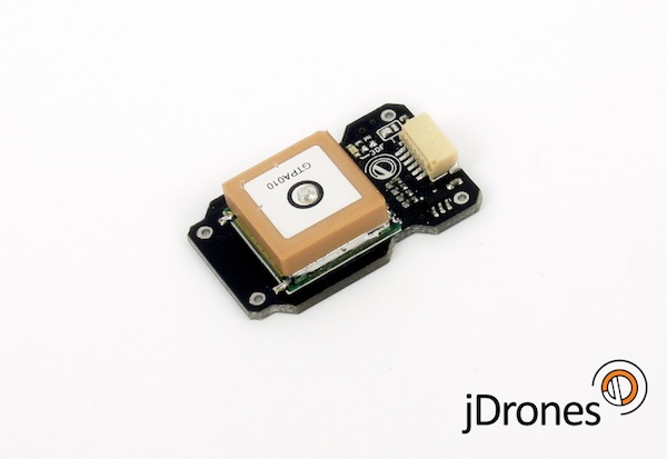

Comment by Jani Hirvinen on June 4, 2012 at 7:44am
We have even easier way to do it. If you don't want or cannot to modify your GPS board. We at jDrones made new board for it and this board have even bigger groundplane compared to original MediaTEK GPS
There will be an additional board soon for this GPS too that will be mounted under it. On additional batteryboard we have place for CR2032 battery and also keep alive charging circuits for it.
On board there are small solder jumper that chooses if you have internal backup battery (eg. none) or external battery. External battery feed is connected on trough holes seen on topleft/topright corners of GPS module

Comment by Jani Hirvinen on June 4, 2012 at 9:52am
Dror.. well if you don't know/remember, jDrones is one of the core developers for ArduCopters (Original ArduCopter is our creation) and others. So we know exact requirements for the software and naturally they are 100% compatible with all APM electronics.
