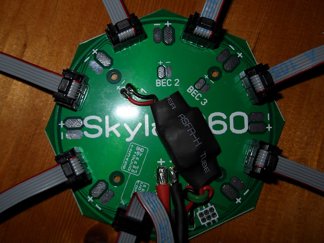

Do you have any Schematics on how this is all wired up?
Comment by Marten on October 12, 2012 at 5:29pm
I don't get a schematic at this moment.
But it's a easy setup with the RGB led's and the Nano connection.
Here some pictures from our self designed PowerBoard and the Led's:
I hope this will give a better idea.
Later I will come back with a complete schematic.
Comment by Tom Griep on October 13, 2012 at 6:23am
I am assuming that the Nano reads the pins from the APM and then blinks the LED's. Is that how it works?
Comment by Marten on October 13, 2012 at 1:39pm
Hello Tom,
Yes that's the way how it works.
