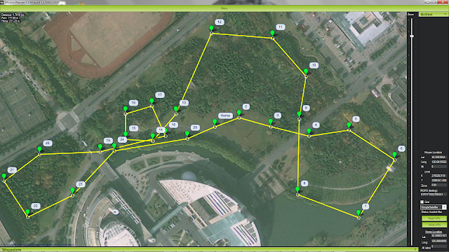

SplineNav Waypoints
We collected the waypoints for this video while flying FPV, and flipping the channel 8 switch at each point to record. Then we loaded the waypoints into Mission Planner, and made some small adjustments:
Waypoints recorded during FPV flight and adjusted in Mission Planner
