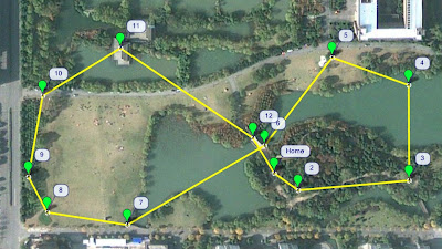

I collected the waypoints for this video while flying FPV, and flipping the channel 8 switch at each point I wanted to record. Then I loaded the waypoints into Mission Planner, and made some small adjustments (Figure 1). I also checked them by flying SplineNav at low speed first, and watching via FPV how close it got to the trees.
Figure 1: Waypoints recorded during FPV flight and adjusted in Mission Planner
After the low speed check I felt comfortable to fly it at max speed, although it was still very nerve racking, because it was zipping by a few meters from those weeping willow trees at about 60 km/h. I'm not sure I could have reacted in time to prevent my copter going to the bottom of the pond had a GPS error caused it to brush the willow branches and careen out of control!

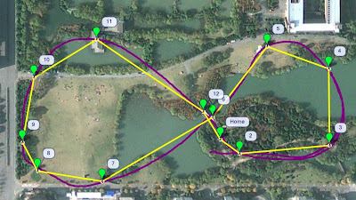

After the flight, I loaded the log data into Google Earth and exported a KML file to overlay on the map, using Mission Planner's handy KML Overlay feature (Figure 2).
Figure 2: Purple track is GPS recorded track during SplineNav flight
As you can see, the GPS track indicates it hit all the waypoints very precisely, expect it slightly missed waypoint 8, which I attribute to the copter having just flown right next to a large building which could have caused GPS signal reflections.

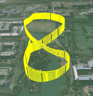

The waypoints had a range of altitudes set, for a more interesting flight. Here is the flight profile from the data logs, imported into Google Earth:
Altitude profile generated in Google Earth from flight log data
