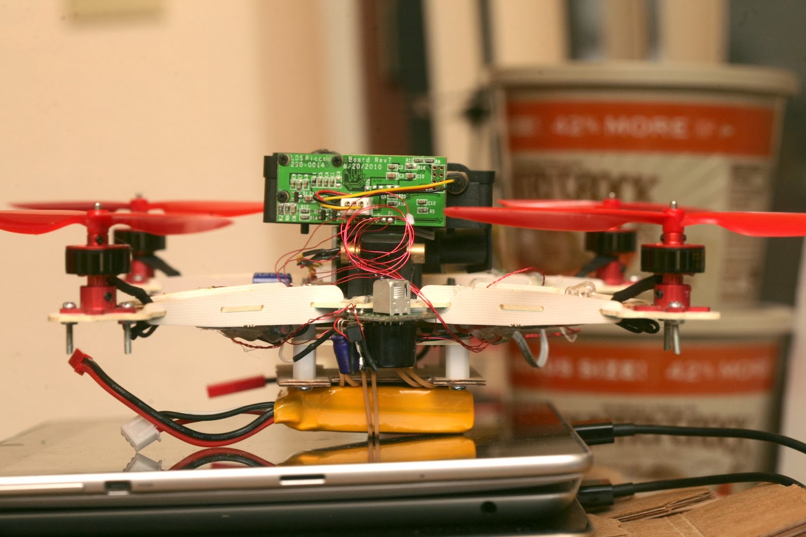

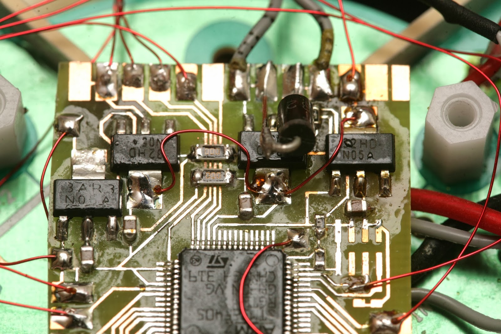

Since it clearly was too heavy to fly in its spinning form, it was time to extract the bare ranging element. The ranging element weighs 30g. The PX4flow weighed 17.5g. The board has 5V labeled, but it's converted to 3.3V by an LDO.
red: 3.3V
black: GND
orange: photodiode output
3.3V when interrupted 0V when clear
brown: TX data going into device
green: RX data going out of device
In true silicon valley H1B worker fashion, the TX & RX labels were reversed.  TX on a device normally means signal going out of the device, but the sensor has it meaning signal going into the device.
A 220uF cap filters the 5V power. A 100uF cap filters the 3.3V power. The UART signals have 4.7k resistors.

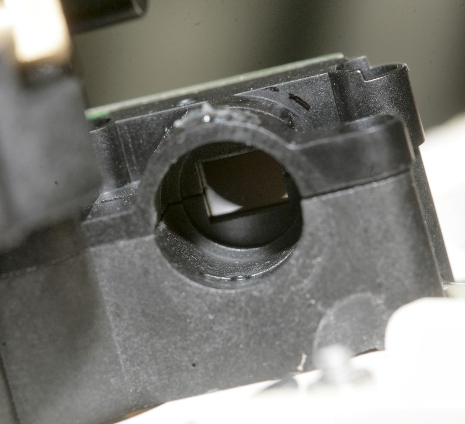

The lens is variable focus with 1 screw clamping it down.  Once unscrewed, it becomes lose.  There's no way to focus it without an unknown debugging mode.
2 of the modules had smaller lenses.  1 had a larger lens.

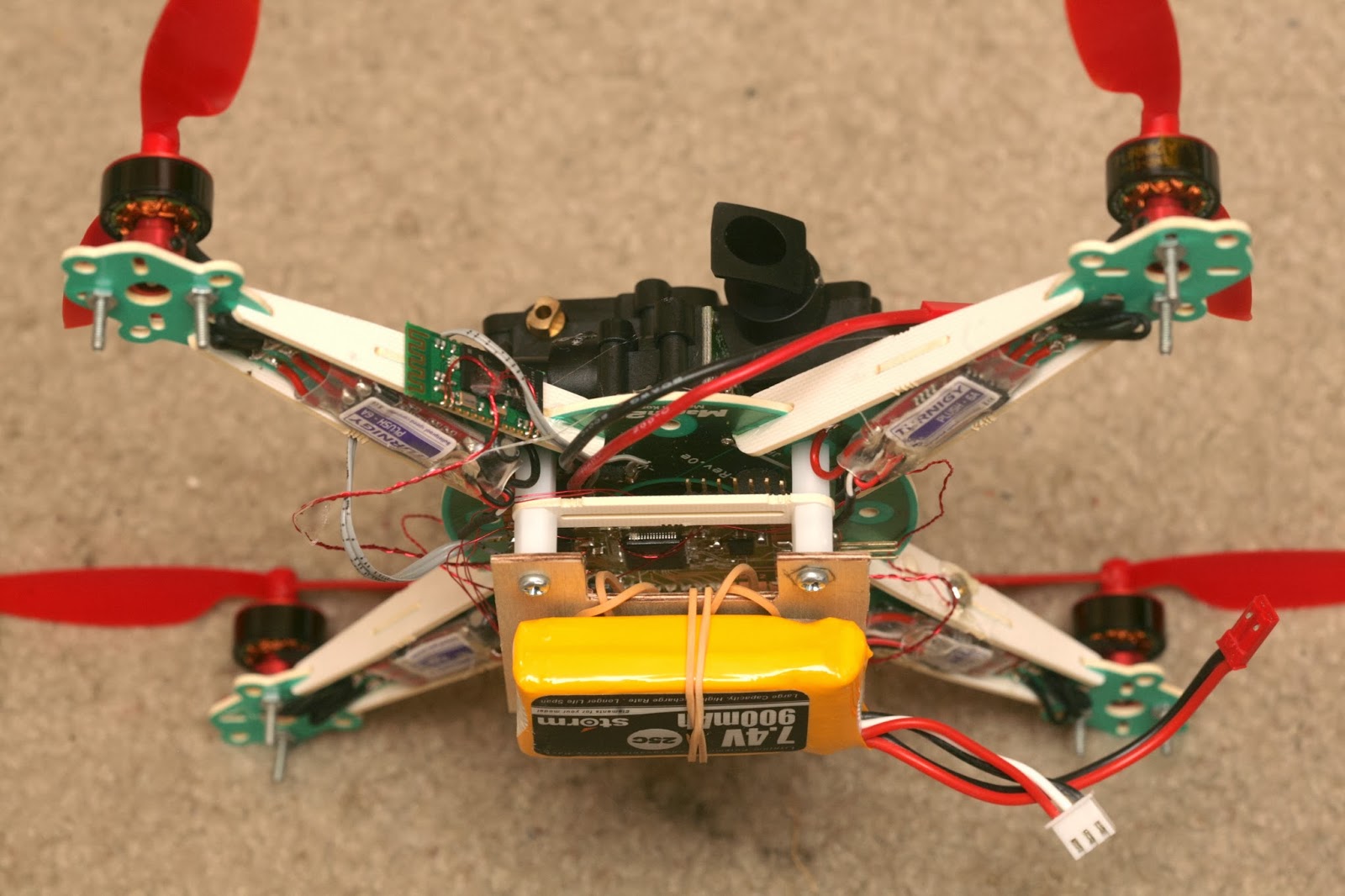

A 1st attempt at attaching everything led to a huge brick.  It's going to be really slow.  There's no durable way to attach the 2 LIDAR modules.

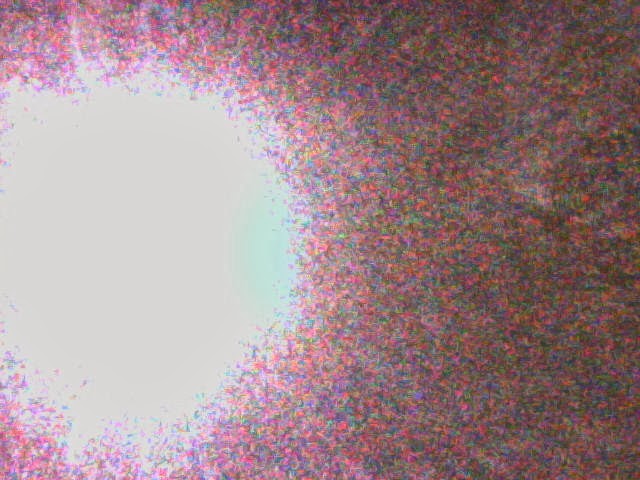

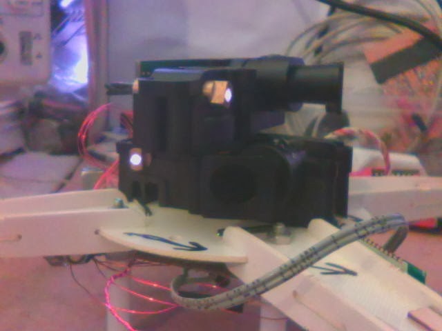

A crusty webcam reveals the IR laser.  It would be bad to look at it.  It's actually correlated to the rotation speed.  It doesn't turn on if there's no rotation.  It's very faint if the RPM is too high or too low.  It's only fully on inside the narrow RPM range.
So hacking it to stay on with no rotation & using it as a horizontal range finder is a dangerous application of something that's safe in its normal application.  You definitely need laser goggles.
 RPM out of range
RPM in range
 1 of the sensors failed.  Tried focusing it, but it wouldn't detect farther than 1m.
 It doesn't have any focusing threads.  It just slides in & out.

After a full day of replacing the sensor, the complete stack briefly flew manually.  It took nearly full power.  IMU drift was too high to fly more than a minute.  2 PWM pins were swapped.
The only way for the coordinates to work was to assume it was always pointing north.  The calibration has to face the direction it's going to point when flying.  Rotating the lidar output to point in any arbitrary direction caused massive glitches, every time it slightly rotated.
The video has several attempts to hover, several attempts at a waypoint mission. The waypoints failed because of an unknown software bug. The final flight was an attempt to hover, with the PID gains converging in on decent values. The testing ended when an arm broke, despite all the double layer wood.
Altimeter was all over the place. Seemed to be power distribution interfering with the cable routing or having the mane board under the frame.
Flight time was 2 minutes & maneuvering was real lousy. It definitely moved like a single female, very overweight & unwieldy.
It had to stay far from the walls to prevent crosstalk, yet be close enough to prevent detecting the floor. Didn't have any obvious floor detection at 1.5m from the walls & 0.3m altitude.
Velocity needed to be updated at 10Hz to have any success.
Absolute position was excellent. There was no more drifting.
Would recommend wearing laser goggles.
IMU drift made it drift. Would need to start over on the vibration problem, with the new board arrangement.
