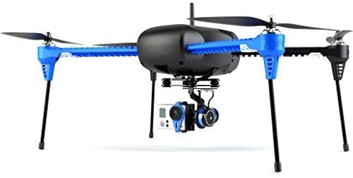

3DR IRIS gets approved in France by DGAC (french FAA).
B163-IRIS-Attestation-de-conception-de-type-page-1.png?width=250
After a few weeks of administrative processing it is finally here, the "Attestation de conception de type" (Type certificate) allows the 3DRobotics IRIS to fly legally in France in scenarios S1, S2 and S3. S3 meaning it can fly in urban areas as well !
B163-IRIS-Attestation-de-conception-de-type-page-2.png?width=250
We're working with the DGAC on revision 2 of the type certificate to get the IRIS+ approved.
The IRIS+ looks like a great enhancement of the 1st version and we can't wait to receive ours to try it out. Along with the Gopro 3, this is a great setup, looking more and more like a tool than a toy.
Working out of the box, easy to fly and carry, capable of 4K video and benefitting from all the features of the Pixhawk controller, no doubt the IRIS+ will be a great machine for numerous jobs.
With more lightweight sensors coming up (multispectral and thermal cameras, LIDARS, etc) the IRIS+ may also proves to be pretty versatile.
Now if Teradek or Paralinx could make a 4K, sub-milliseconde latency, lightweight wireless video transmitter... (providing that the GoPro does indeed output 4k over HDMI).
