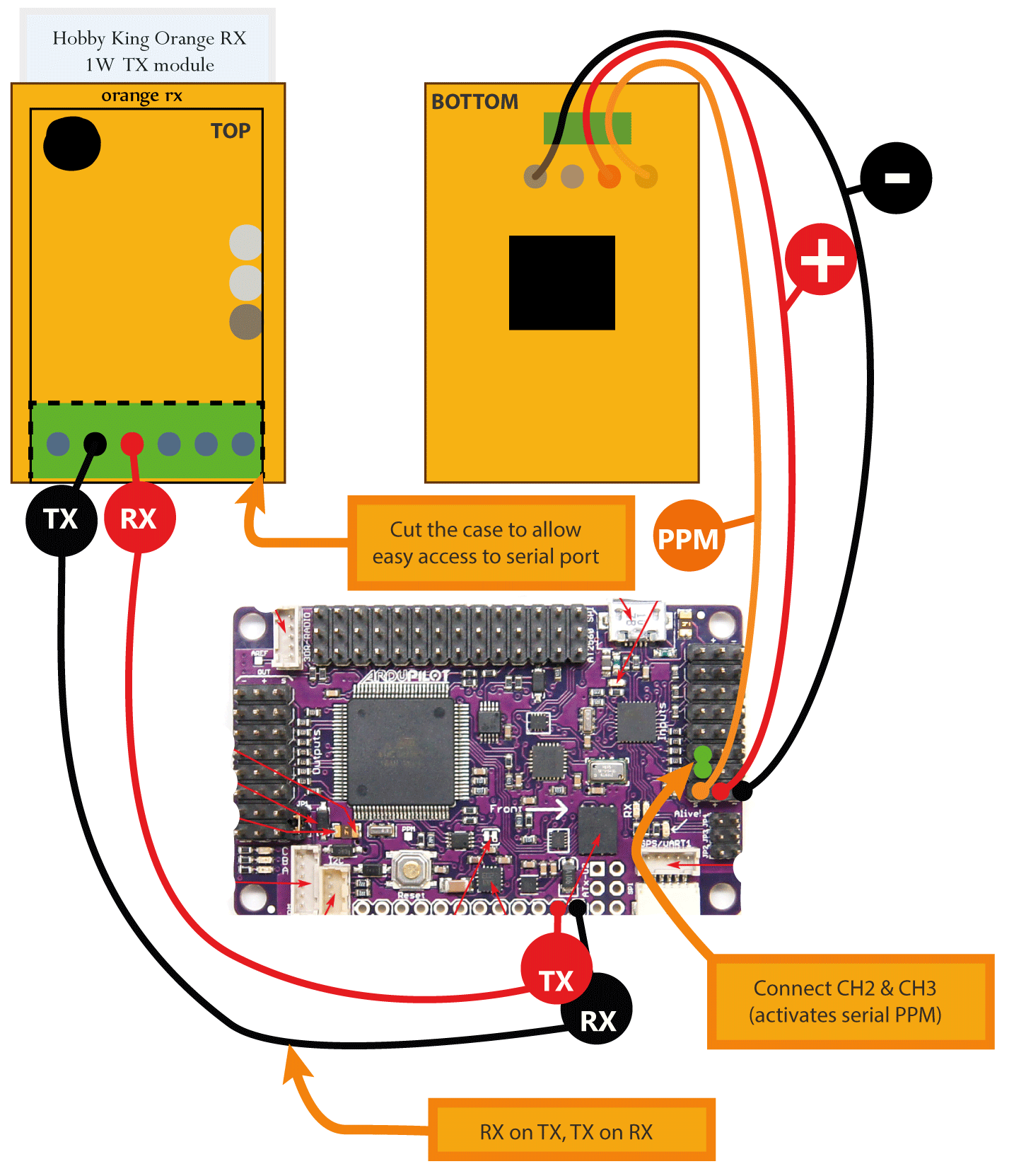

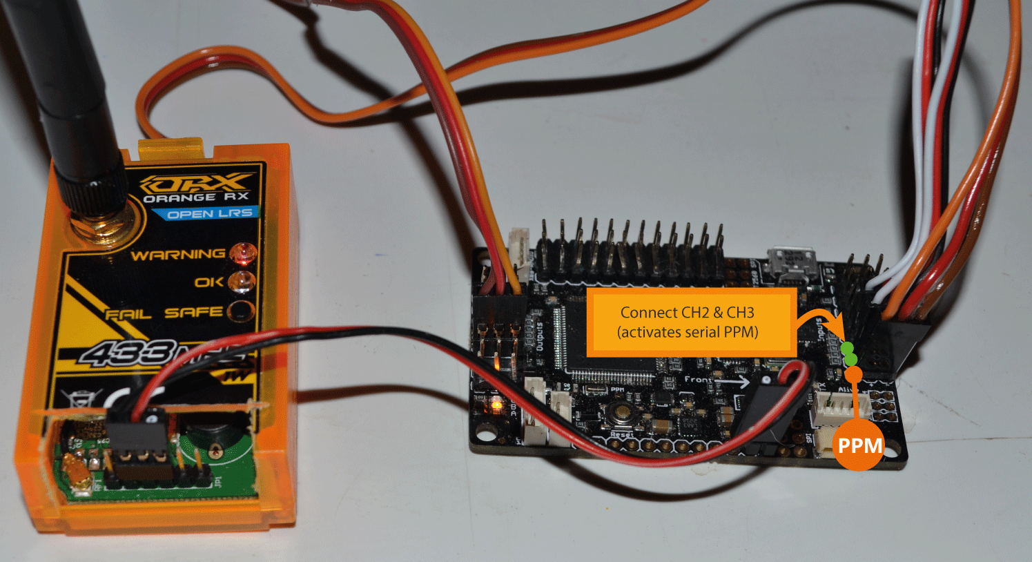

  • Hi, I've made a custom firmware in order to make OpenLRS hardware work well with APM with a 1W bidirectional link.
    So far I've gone 10 km away with full APM telemetry. No need to modify anything on APM, no need to ctrl-T, all parameters are sent correctly, everything can be modified even during the flight, such as changing PID parameters or sending a new mission.Of course RC is sent as well.
    Described here :
    http://www.itluxembourg.lu/site/
    Discussed here :
    http://www.rcgroups.com/forums/showthread.php?t=2037442
    OLRS2.png?width=400
    photo-OLRS-full2.png?width=400
