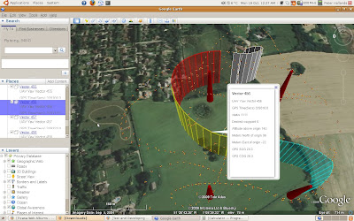

  • Thanks for the work Pete. It's looking good! I recently added the Time of Week output to my flight logs.
    ie: !!!TOW:422022750,LAT:32248268,LON:-110833968,SPD:27.76,CRT:0.00,ALT:66,ALH:50,CRS:126.28,BER:218,WPN:0,DST:455,BTV:0.00,RSP:35,***
    I plan on trying to use this in your script to create a "playable" timeline of the flight in google earth.
    I'm sure you have a few legs up on me in this, but it seems that it would be a cool feature.

  • Thanks for the info Peter. I'll definitely check it out, as it seems more robust than mine.
    It does not integrate with GCS. I've been just leaving the laptop in the car with a terminal running on the XBee receiver, then saving that dump to a text file.
    Attached is a sample log file that I'm using (flight_log_3.txt)
    And the python script that I use to convert to a KML path (ardulog2kml.py)
    Here's how it's run...
    johnc@kabaseo:~$ python ardulog2kml.py
    What log file do you want to open? flight_log_3.txt
    johnc@kabaseo:~$
    It currently outputs "file.kml" that you open in GE to see your track. Suggestions are appreciated!
    Hope this helps someone else too....it's helped me.
    Definitely going to check out Peter's work as well.
    Thanks!
