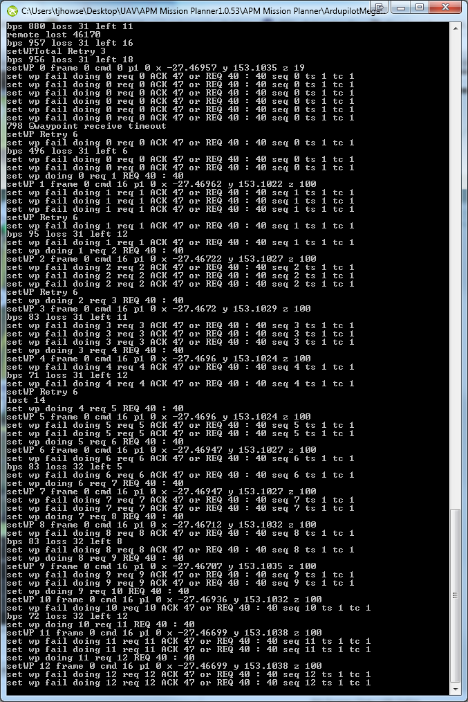

The problems started when I tried to communicate via the radios. I could sometimes get all the way through reading the parameters, but only rarely, before the connection dropped out and "Not a 1280... Not a 2560" was written to console. I've dropped the baud rate down to 9600 in the modules and on SERIAL3_BAUD in the APM firmware and now I can maintain a connection indefinitely, but there are still many dropped packets. I am about 50% successful in downloading a set of 22 waypoints without it bombing out with the error (displayed in a popup dialog box, not the console):
Error : System.Exception: Timeout on read - setWP
    at ArdupilotMega.MAVLink.setWP(...
    at ArdupilotMega.GCSViews.FlightPlanner.<BUT_write_Click >b__7()
Screenshot of waypoint download attempt:
http://www.tjhowse.com/hackerspace/uav/errorlog.png

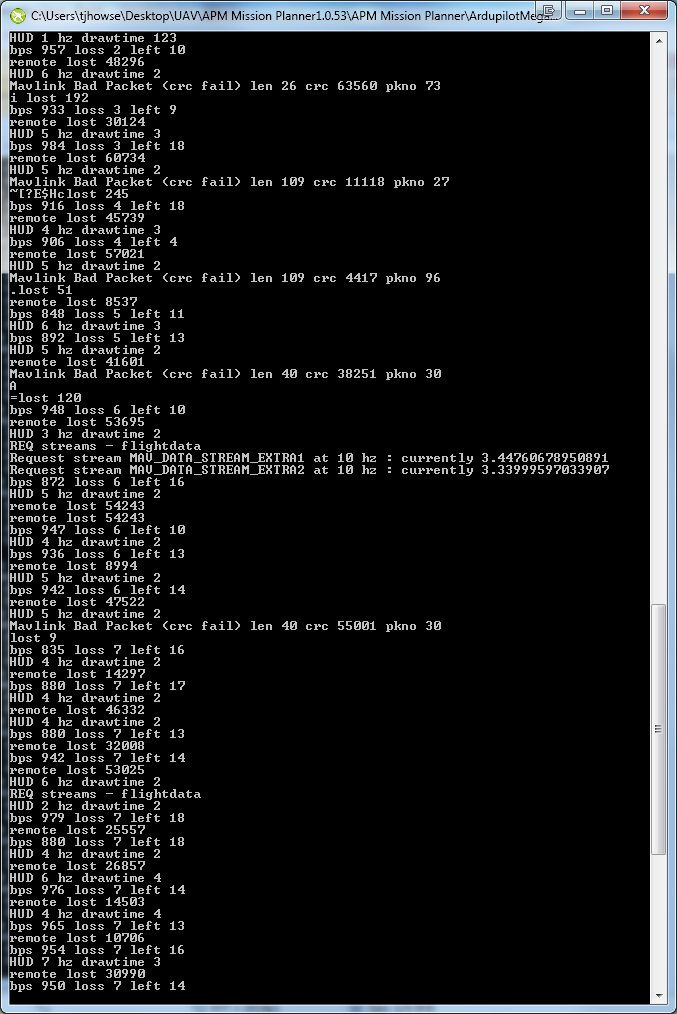

Screenshot of idle operation:
http://www.tjhowse.com/hackerspace/uav/errorlog2.png

I've reduced the TX power to 100mW from the default 1W. 100mW should still be ample to reach the other end of my house, though it's no better or worse than when it's in the room with me. I've also updated the firmware on the telemetry modules to the latest.

  • It should also be noted that the radios range test fine. 2000 successes, 16 fails. 99.2%, using the range test utility in X-CTU.
