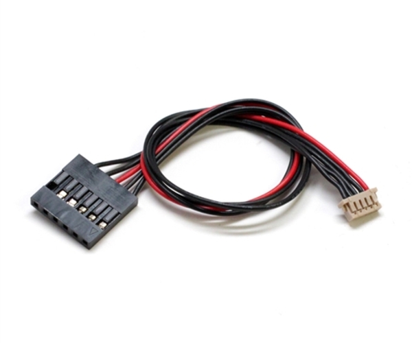

  • @Seppo,
    Do you have a diagram (or photo) that shows which antenna goes where?
    I ordered the RFD900+ Modem Bundle, but failed to notice the cables for the APM/Pixhawk were not included. It looks like it cost quite a bit more to ship the cables than the cables cost.
    Would this 3DR cable work:
    http://store.3drobotics.com/products/telemetry-adapter-cable-for-ap...
    KT-APM25-Cable-2.jpg?1393191029
    • Hello Bill,
      Yes, I believe this cable will work with an APM 2.x series autopilot.
      Pixhawk's have a 6 pin termination on the DF13 side.
      Antenna wise, the best configuration depends on the size of the airframe.
      Larger airframes would be able to accommodate dipoles, where smaller airframes would need monopoles, with groundplanes ideally.  The modems will work OK with the smaller antennas used directly, but, performance will suffer a bit.
      If you have some pictures of your setup guys on the forum / myself would be able to give feedback..
      Cheers,
      Seppo
