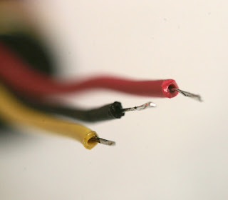

The Castle Creations 6 is really badly soldered.  The 12-30-4110kV Electrifly has incredibly flimsy wires.  It's obviously high flex cable & I should have left the bullet connectors on, but they looked heavier than they were & they easily broke off.

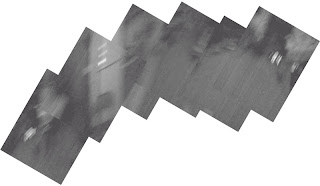

 The 1st images at flight RPM were pretty bad.  A refrigerator & chair are visible.
Instead of hitting head on, the camera scanned diagonally, causing sheering in addition to vertical compression.  At the highest shutter speed, it was still pretty blurry.  Each revolution has 6 frames, so forget about lining up a frame on the same spot.

 Camera rotation improved matters.
images03
Increasing the camera to 30fps, letting it drop 1/2 the frames, & letting it drop magnetometer samples got more overlap.  If there was a way to automatically align everything, this might work.  Slow scan 640x480 was useless.  The trend is towards lower resolution & higher clockspeed.

 Automatic placement didn't go so well.
images08
 Rotating manually matched a little better, but since the camera was pointing diagonally, it only needed 90 degrees of rotation.  If it pointed straight down, it would rotate 360 deg.
Playing with the Marcy 2 cam showed the realtime 360 deg panorama isn't going to happen.  There's no way to align all the frames fast enough & the information is too noisy to convert to an altitude & position.
