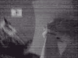

So that was the axial pointing camera revealing new rolling shutter distortion.  Instead of uniform vertical squishing, the top right had stretching & the bottom left had squishing, in both directions.  That is correctable, by knowing the rotation rate & scan rate.
This was the best arrangement.  Moving it from the wing to the balance beam got the Y axis on the camera to always be parallel with the spin axis.  If the camera was on the opposite side of the spin axis from the wing & on the balance beam, its field of view in its X axis would cover the spin axis instead of looking away from it & its Y axis would always be straight down.
So the camera could look straight down the spin axis just by repositioning it on the plane of rotation instead of building a diagonal harness.
Also noticed there was a good chance the attitude could be determined by looking at the takeoff stand's position in the frame.

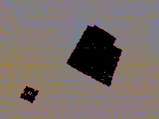

Anyways, object recognition with SURF was worthless on the 160x240 video.  There seems to be a minimum complexity before SURF detects a feature point.  The resolution isn't high enough to hit that minimum complexity.
At flight altitude, the marker is gone.  The AR Drone required much higher resolution just for detecting velocity.
With the camera pointing at the floor, there might be a future in chroma keying.  The floor is more uniform than the ceiling.
Marcy 2 would require covering a large area of the floor in markers.  The field of view is too narrow for a single marker.  A simple grid with different codes in each square would do it.  A flashing laser projected from the aircraft, off axis from the spin axis, might give altitude.  Sonar altitude is too expensive.
 With the camera limitations & frame rates now well known, any kind of object recognition was ruled out.  The only real option was what it was on Marcy 1: color based blob detection.

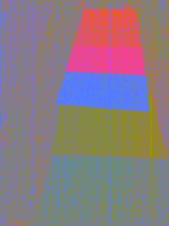

chroma
Setting the camera to only record chroma reveals it detects RGB.  Yellow doesn't show up at all.  Some fluorescent pink posterboard showed up nicely.
Even with it pointing down at a featureless floor, chroma keying was still a problem.
The onboard camera didn't work as well as the DSLR.  It was in chroma-only mode to get enough information to do chroma keying at 25fps.  The color resolution was 160x240 & the hardware saturation was at maximum, which still allowed a lot of saturation changes.
Surprising how well the blue came out.  Humans must not see it as well as cameras.  Yet it detected pink better than red.

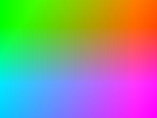

Saturation & hue were still being captured.  Maybe it would go faster if just the hue was captured.
Plotting all the possible chroma values, a 256x256 lookup table emerged, in which chroma was converted to hue.
The result was such a noisy image, it actually increased the bitrate & sent the framerate down to 15.  Not the intended result.
What looks like more differentiation between green & background, the computer actually didn't notice. It still detected the least differentiation with green & the most differentiation with pink.
