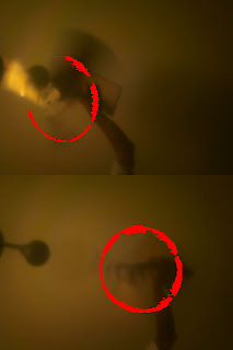

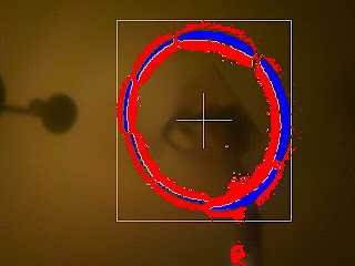

A human looking at this thinks there must be a way to detect the inner red edge & extrapolate a circle.

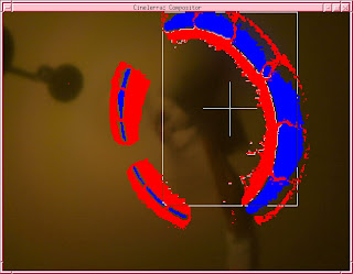

It's not clear why the color facing out is overwhelmed by the color facing in or why the blue has a red outline.  The shape while rotating is completely different than stationary.
A hard edge is required to get an accurate semicircle.  So another algorithm emerges.  Once again, scan for all the red blobs.  Take only blobs with a minimum number of adjacent blue pixels.  Take the center of the largest blob as the center of the circle.  Test rays from the center.  Take all the points where the ray turns from red to blue or off.  Extrapolate the circle dimensions & center as with Marcy 1.
A rough experiment could just scan all the red pixels & skip blob detection, but if someone flies in a room full of red LED's, there's going to be a problem.
So much for that.  The circle isn't always contiguous.  It's more of a camera limitation than an algorithm flaw.
The worst the camera did.  Those red gaps between the blue are also a problem.  All roads lead to another board camera.

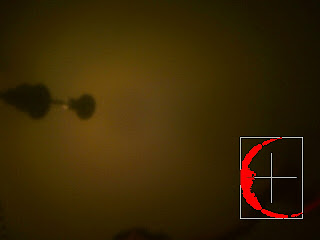

Then came flashing LEDs & just the red LED.  Flashing was pointless.  The red bleeds too much & the blue has red fringes.  Having just the red LED was promising.
 Without paper.
With paper.  It unexpectedly showed a hard edge.
Maybe 2 red LEDs would be better.  A new algorithm slowly emerges, in which the largest blob from each frame is detected before the accumulator.  Then, the accumulated blobs are measured.

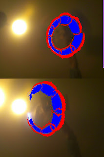

Position tracking in ambient light is really starting to gel.  These were hopefully worst case scenarios.  The typical use would be a room with fluorescent lights pointing down from the ceiling or fluorescent lights pointing up through a lampshade.
Blob tracking as opposed to Marcy 1's straight luma keying is definitely required.  The red LED won because there isn't a trend toward replacing CFL's with red LED's like there is with white LED's.
Red shows pure red.  Blue has a ring of red around it.  A white LED shows blue & red.  Not sure how a room lit with white LED's would handle.  It would definitely take feature detection, with a POV pattern under the wing.  Maybe throwing out blobs with adjacent blue.

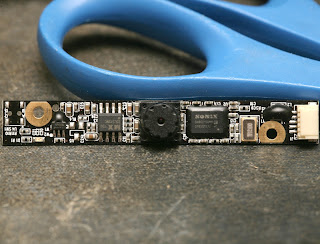

WEBCAM VS BOARD CAM
A webcam is all but useless & unaffordable.  The actual camera would be a board cam, able to stop down enough to knock out all color saturation.  The exposure must also be long.  It would be much harder to track if there were gaps in the circle.
There are ways to make an IR camera, but you know why those Vicon rooms don't have windows.
The availability of one hung low brand webcams for $3 makes one doubt the viability of $10 board cams. Webcam rolling shutter & scan rate is worse.   They're much bigger than the $10 board cams.  Webcams continue to have very large circuits, in addition to the camera module.  They wouldn't be practical on the aircraft.  The 1 hung low brands don't have enough manual control.

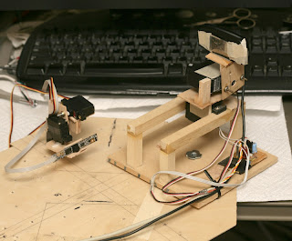

DESIGNING AN EQUATORIAL MOUNT
As predicted, a ground based camera gimbal needs a lot of labor & parts to assemble.  The trick is finding the simplest, most compact, uniform parts.  The software for aiming the equatorial mount is also a buster.
So the minimal cost equatorial mount ended up a lot bigger than the alt/az mount, even with the micro servos.  The mane reason is the servo  shafts aren't in the middle, so the attachments need to clear a very wide box.
You'd think servos would have evolved to have centered shafts by now, but the old 1 sided shaft is the most efficient design.  The mount could be smaller, by using more complex parts.

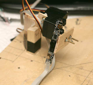

 Next came the most compact equatorial mount, using more unique parts.
It's definitely smaller than the alt/az mount.
 Considering the uninterrupted hemisphere view, it's surprising more antennas don't use equatorial mounts.  The next great task is software to aim it.
Given X & Y in the image, calculate the direction in the ground plane & the servo steps to center the image.  X & Y in the image aren't X & Y to the servos.  It takes serious highschool algebra to convert between image & servo reference.
