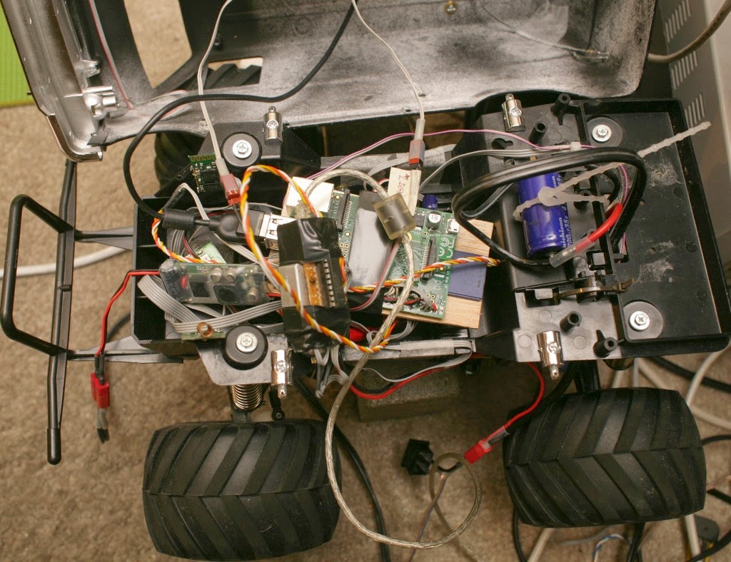

When money started flowing again in 2015, it was finally possible to build a useful platform: the Lunchbox
3689690098?profile=original
The lunchbox was ground up to support a 3S 5Ah battery & a brushless motor.  This extended it to 14 miles on a new battery.  The brushless motor allowed easy sensing of RPM by sensing a GPIO on the ESC.  SimonK firmware allowed an old copter ESC to be repurposed for going forwards & backwards in the ground vehicle.
Attention had always been on making an athlete exert a constant power by having the vehicle develop a constant motor power.  The problem is power into a motor doesn't equal power out of the motor, so every method to regulate the power of the motor by current sensing or constant voltage failed.
There is a way to do it by regulating RPM based on the incline sensed by an IMU, but this would take quite a bit of experimenting to get the right amount of human effort for every incline.  Eventually, the best workout proved not to be a constant effort for all inclines, but random changes in effort manually programmed in based on feelings.  A simple phone interface for dialing in a constant RPM proved to be the best solution.
With the Lunchbox platform now capable of fitting a decent payload, attention turned to making it drive itself.  This would allow photographing the athlete from multiple angles outside the athlete's field of view.  This was a very difficult problem & put into perspective the last 12 years of hype around self driving cars which were always just around the corner.
A raspberry pi 1.0 did the processing.

There were many edge detection algorithms, chroma keying algorithms, variance sensing algorithms.  Then an Odroid was installed, which provided a massive increase in computing power.
But while getting machine vision farther than it ever went before, it wasn't robust enough for practical use.  There was a video of the peak of Odroid guided driving with some manual intervention.
Machine vision was deemed the best solution for a worker budget, not LIDAR, not sonar, not GPS.  The mane limitation was shadows.  It was easiest to semi autonomously control it.

The next step was to build a 2nd vehicle for the day job, while the lunchbox would be used at home, 50 miles away.
New semi autonomous controls were built for 2 vehicles.  The lunchbox was modified for cargo.
a8707555-230-lunchbox01.jpg?width=480
a8539088-103-ruckus07.jpg?width=480An ECX Ruckus was converted into a 2nd semi autonomous vehicle.
a8677655-199-20160204_124656.jpg?width=480
The mane requirement for the Ruckus was to be narrow for navigating the city.  This had a range of 18 miles on a new battery.
Even without autopilot, this vehicle was controllable enough from peripheral vision to record mostly side firing video.
