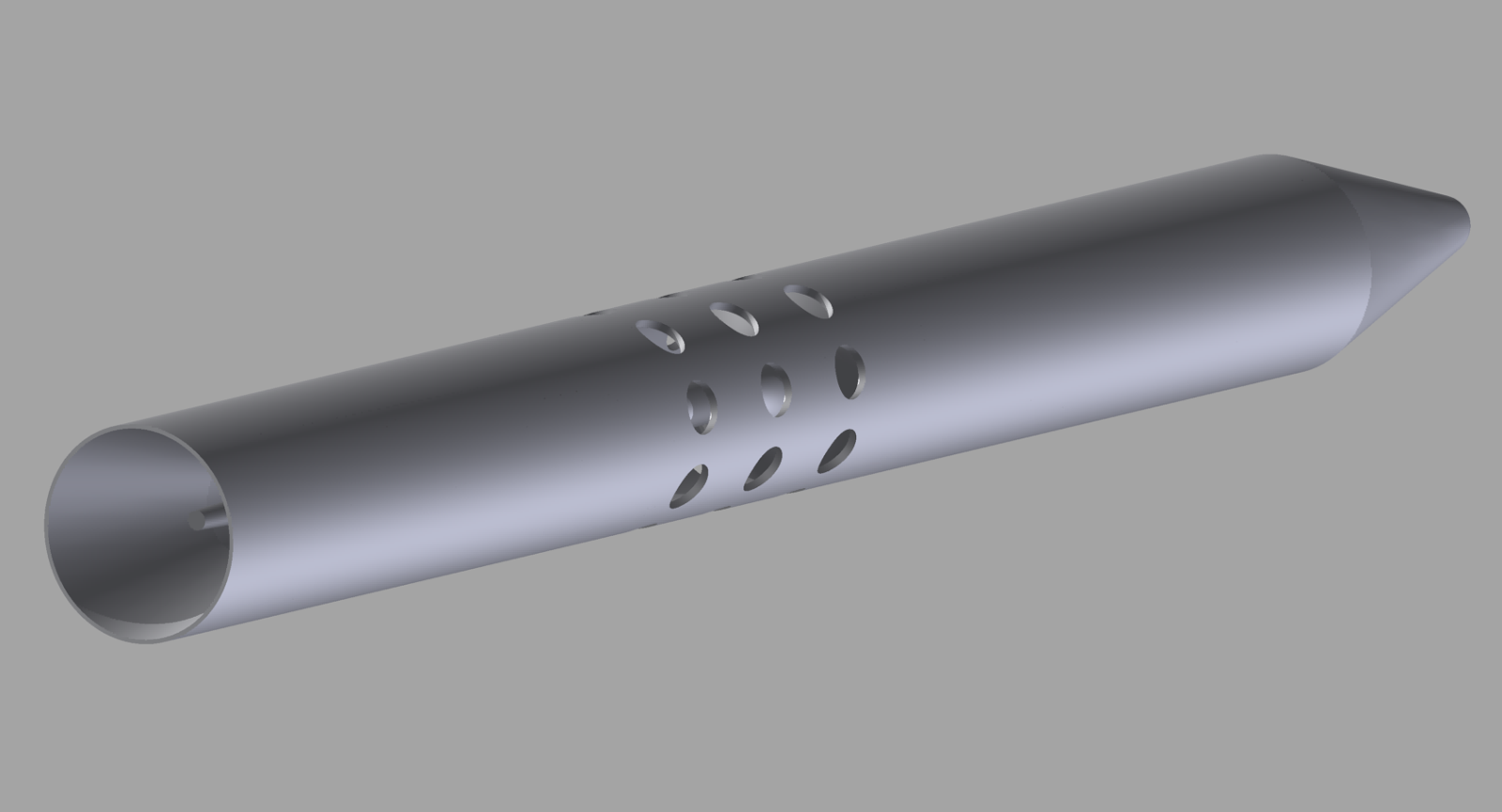

In this article, we have familiarized with the total pressure probe and highlighted some key design points. In the next article we will proceed to present some results regarding the proposed BAD probe.
Figure 4. Generic Design of BasicAirData probe. Dimensions are not definitive.

The total pressure probe will be, as soon as I've some time to test and publish, mainly composed by 3D printed parts; so easy to build and assemble

Very nice work. However this could be hard to construct right? Some pretty advanced CNC machining has to be involved to construct one of these, with different assembly parts right? Do you have an application in which you need to measure flow angles up to 40°?
