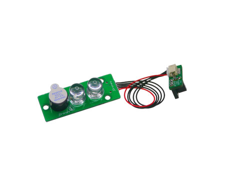

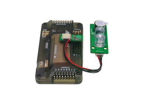

    William, yes you are correct on that current usage. There are already been some brownout problems on main CPU and having LEDs, Buzzers etc directly on CPU IO Pins is always a big dangerous. That's why we originally made IOBoard to support high current LEDs for original copter leds application.
    To avoid getting in to problems we made new board for Led/Buzzers. It is similar to the board that Charles made but having drivers for everything.
    This board does not use any current from CPU IO Pins, all of it's parts are transistor driven and it is getting it's power from 5V power rails directly. So no stress to CPU. Connection cable is DF13-5Pin so length of the cable can be easily changed. Also there is an adapter that mounts nicely on top of APM and in future to PX and other boards.
    jD-Ledbuzz_P1.jpg?width=500
    jD-LedBuzz_P3.jpg?width=400And as always, boards can be found from jDrones store
    Use LED_MODE = 11 for these boards.
