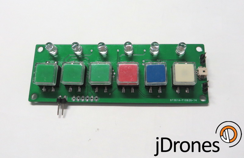

6 Way mode switch gets life...
Finally after several iterations on PCB and electronics design, first jDrones ModeSwitches are getting to daylight.
First boards are fully operational and we are testing them with several of our test flyers.
Stefan made original Arduino Sketch for his boards and we started to work from point forward.
There are total of two models of this ModeSwitches coming. One is this as shown on above and another will have even more intelligence in forms of OLED displays and programmable menus.
Later boards will be installed on nice cases and we are looking now what type of cases to use for these boards.
Features of the ModeSwitch:
  • ArduPilot specific flight modes, 6 modes in total
  • Easy to connect to RC radios. Use trainer port, has 3.5mm jack and pin headers
  • +5V and +12V operation voltages with polarity protection, DF13 connector and pin headers
  • Removable caps on switches for mode texts
  • Size 35 x 100mm, yes it's long but also has big easy to access buttons.

    Status updates:
    - 3rd set of PCBs are currently in factory and they will arrive soon
    - It has now passthrough port so everything else except Ch1 will be passed as it comes in to output
    @martin, i don't see why it would not work with DX6i. Board does not care on/off channels. It reads all 8 inputs and puts them to out (except ch1).
    It's more or less features of the radio how you can configure that which input does to what output on your radio.
    Our upcoming OLED module will have much better configuration options as then you can define all input/outpus channel orders etc on that.

    Jeff, we should have it on market in about month or so. Currently working on enclosures etc. After those are solved we will release first set.
    Check out this bebe... OLED post as promised: http://diydrones.com/profiles/blogs/arduino-modeswitch-with-oled-di....
    Menu system is well working and we are doing some monitoring functionalities now for passthrough features
    @Euan, yeah caps are removable so you can easily put texts on those piece of papers. We are still looking some alternative buttons and especially one that have lights in them but in meanwhile these are the buttons that we plan to use for now.
    OLED is naturally LIT.
    Bracket is something that we are thinking of. Final bracket model depends on the case what we start to use. I am open for suggestion.
    @Stefan, my guys are already doing that reading/manipulating firmware. All future boards will have both PPM input and PPM output jacks. OLED version will have menu system that allows you to configure what/where/how signals will be manipulated.
    Yeah I am trying to find a company that makes those 3.5mm jack / Futaba adapters.
