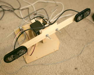

The largest problem was the 160mA required by the IR leds to give a light field the cameras would see.  This was the introduction of a pure IR camera system.

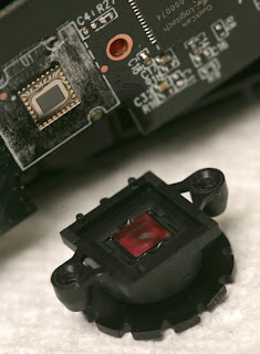

IR filter from edmondoptics.com was invaluable.  You need a filter which passes the IR band without attenuation to get a high enough frame rate.  Floppy disks & film rolls neither do that nor are they still produced.
The camera of choice was the Logitec C210 webcam.  It was cheap, had manual exposure control, decent picture quality, & was easy to convert to IR.

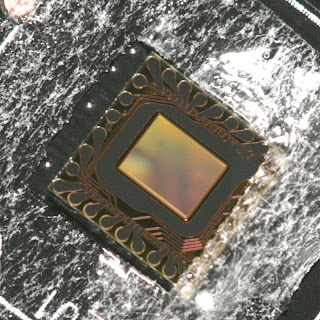

Unfortunately, the mighty TCM8230 from $parkfun couldn't be converted to an IR camera.
The IR filter is too close to the sensor to remove without damaging the sensor.

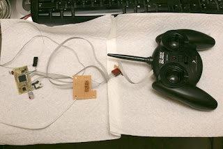

Overriding the Blade MCX remote required just a 100nF, 1k, & 600khz PWM to generate a stick voltage.  The sticks were now overridden by software.  A 0-3.3V range was all that was required to control it, even though the stock remote did 0-3.5V.
It was very useful to have a 2nd controller to fly it manually, testing for whether a problem was in the autopilot or natural instability.

Solid IR leds have been superior to flashing, visible LEDs.  The IR spectrum has a lot more unused bandwidth.  They are still overpowered by lightbulbs & sunlight, but it won't be sunny here for another 7 months.  If only they didn't need so much power.

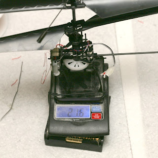

 21.6g with no canopy or autopilot.

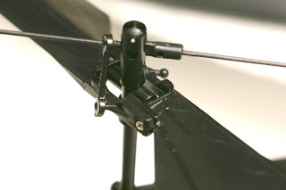

1 of the Blade MCX's developed a natural oscillation, early in its conversion.  There's no record of Blade MCX's developing a natural oscillation, on the goog.  The oscillation remaned, whether or not the autopilot was installed.  Nothing looked mechanically different or unbalanced, compared to a working Blade.  This is a mystery mechanical problem.
It turned out, the problem in internet lingo was "toilet bowl effect" & the solution was soaking the flybar assembly in 3 in 1 oil.  So now there are 2 autopilot capable Blade MCX's in the apartment.
