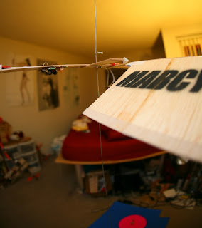

It does work on the test stand, for the most part. There's a lot of lag. There's a dead area directly on the axis of rotation. The range of working ambient light is very narrow. The mane limitation is not knowing where the axis of rotation is in the frame.
  The altitude was manely unaffected by bank.  X & Y were pretty bad.  There is an oscillation from the rotation.  If 1 frame per rotation is counted instead of the 3 in which the blob is visible, the oscillation would go away, but fewer data points would be averaged.
  X & Y seemed roughly aligned with magnetic N.  Further alignment would require stabilizing the test attitude.
The mane event was devising every possible test for position sensing.  Position sensing from a rotating camera & all the trigonometry required was too crazy to believe it would work.  There were a lot of electronic dongles hanging in mid air.  Crashing would get expensive.
When Marcy 2 was originally conceived, there was full confidence that everything currently on the air frame was physically enough to do the job.  Confidence wanes when it's built up & sitting on the test stand.
The leading technique was the old ceiling hung wire, but it didn't constrain bank angle.  As expected, the bank angle drastically impaired position sensing.  When level, the azimuth correlation & blob detection seemed to work.

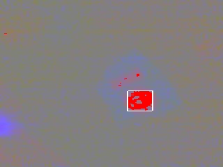

There were a lot of obvious glitches which the deglitching couldn't handle.  The camera detected noise as the target when pointing away from the target.
Thus, the error prone test of a minimum blob size was required.  Manely, the largest blob in the last revolution was taken.  Then, all blobs below half its size were excluded.  A blob greater than 1/2 the maximum could sneak in when the camera was pointed away, for which deglitching would be required.  A real paranoid filter could take only the largest blob from the last revolution.

 Revealing no useful position information during the flight.  The takeoff attitude hold was so accurate, it kept the target halfway off the screen during the complete flight. All the energy getting the camera to view the axis of rotation didn't get enough of it in view to give a target.
  The attitude hold stays active until the takeoff altitude is reached, just like ground based vision.  Only then does it switch to position hold.  It's probably acceptable if the takeoff altitude is low.
The current blob won't do.

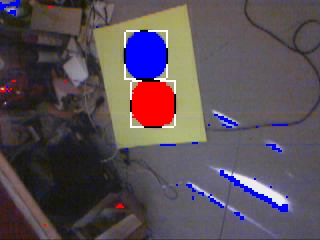

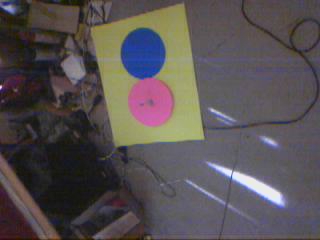

Then there were 2 markers.  Sunlight caused some blue in the chromatic aberration.
Having 2 markers creates a lot of possibilities.  The overlap of the 2 markers can be used to throw out false blobs, but also eliminates some real blobs.  The distance between the 2 markers & size of the 2nd marker can give a better distance measurement, but the distance is affected by rolling shutter.  The blue marker can be visible sooner in the takeoff.
You can see how more targets could be added & detected based on proximity.  Then, the position could be even more refined.

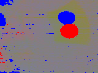

Of course, blue immediately showed the same horror glitches it did before.  Light blue might work better, but it's not mass produced.  Maybe if all blobs were thrown out that weren't a red & blue next to each other.

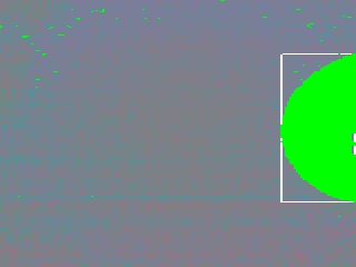

That was disappointing, but there's hope some simple shape detection is possible or some redundant marker can work in the 1st moments of takeoff.  Such a diabolically complicated system like that brings to mind the idea of detecting position from a partially obscured blob.
The radius & center can be derived from the dimensions of the rectangle.  But that also depends on rolling shutter.

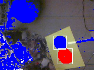

Blob matching based on overlapping boundary boxes of the red & blue got rid of some pretty significant blue noise.  Boundary boxes aren't as robust as scanning every red pixel for a neighboring blue, but faster.
The final attempt in this red/blue combination was scanning every red blob pixel for adjacent blue pixels & taking the largest blue blob.  This was bulletproof at separating the red/blue marker from the noise.
It was a leap in intelligence, actually detecting details in a noisy image from a spinning camera, with complicated rules for switching to the blue blob when the red blob was obscured & throwing out all red blobs without an adjacent blue blob, except during takeoff.
Surprisingly, the blue & red blobs seemed to give very consistent results, right down to Y offset between blobs.

    Did you try YCbCr color space? You could limit BlueMin < Cb < BlueMax and RedMin < Cr < RedMax to detect each markers. Since Y (illumination) is ignored, above inequalities would detect the markers in different illuminations.
    What do you use for processing? a small single board computer?
