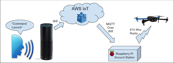

Amazing project from Hackster.io:
ABOUT THIS PROJECT
Voice Controlled Quadcopter Drone
With Amazon Echo, AWS IoT, and 3DR IRIS+

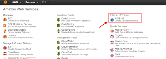

- Log in to AWS Console: https://aws.amazon.com/
- Navigate to AWS IoT

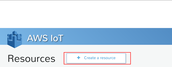

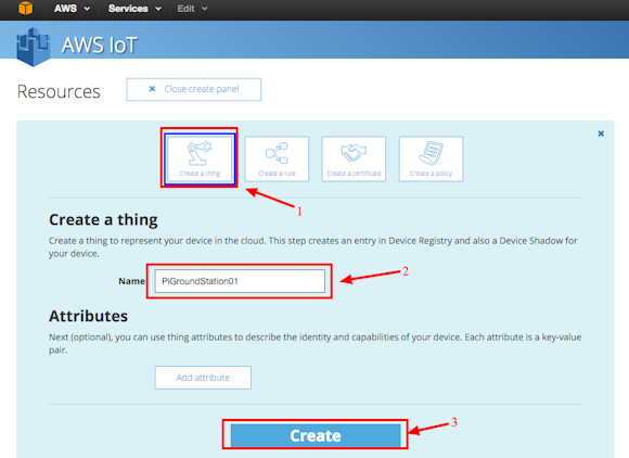

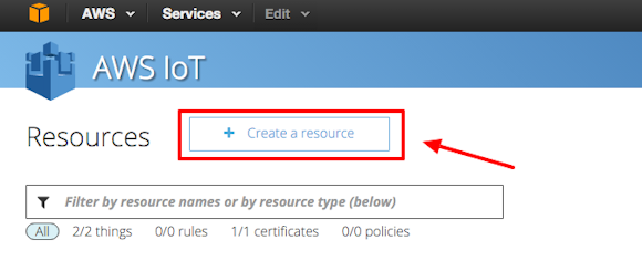

- Create a “Thing”. First, from AWS IOT page, create a resource.
- Now, “Create a Thing”. For this demo I am calling mine “PiGroundStation01”.

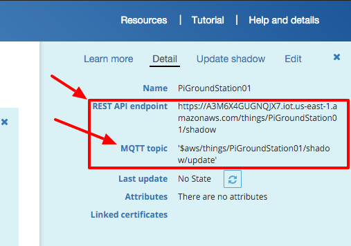

- View your thing. Note the REST API Endpoint on the right panel = looks like: “https://some-random-string.iot.us-east-1.amazonaws.com/things/DroneControl/shadow” you will need this later. Also note the MQTT topic. You will need this later too, when we are editing the python code for the ground station.

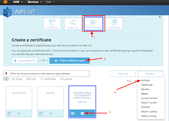

- Next, we need to create a Certificate so that your device can authenticate to AWS IoT. Click “Create a Certificate” and use “1 Click Create” (Steps 1 & 2 in the image below). Download the public key, private key, and certificate. You will need to put these on the Raspberry Pi later. Put them somewhere safe because Amazon will not issue them again, you would have to start the process over and create a new certificate.

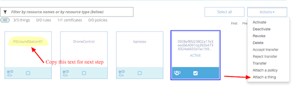

- Then (steps 3 & 4 in the image above) select the certificate with the checkbox, and under Actions menu, Activate the certificate.

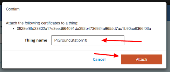

- Now, with that certificate still selected, copy the name of the “thing” you just created, you will need this on the next step. Now, go back to Actions menu, and select “Attach a thing”.
- Now, on the popup layer / form, paste or type the name of your thing and click Attach.

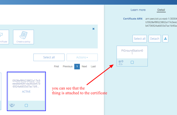

- You can now see that the certificate detail shows your thing to be attached.

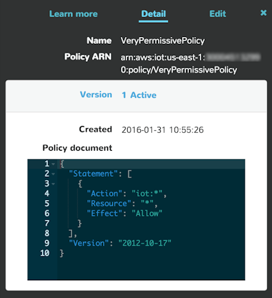

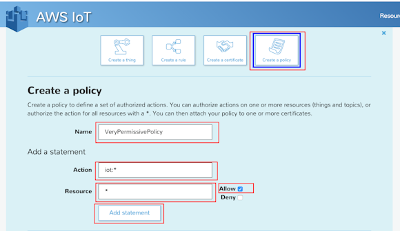

- Now, we have to Create a Policy so that clients using the certificate will be allowed to connect to the endpoint. We’re going to create a very wide open (wildcard permissive) policy, to make this easy. In production environment you will want to create a policy that is narrowly tailored to achieve just what you want to achieve and nothing more. Click “Create a resource”:

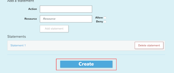

- Create a Policy and fill it out like the below (you can Name it whatever you want). Click “Add Statement” when you are done.
- Now, you should be able to see Statement 1. Scroll down a bit, and click the big “Create” button
- Look up on the top right panel, and you should be able to see the details of the policy you just created.

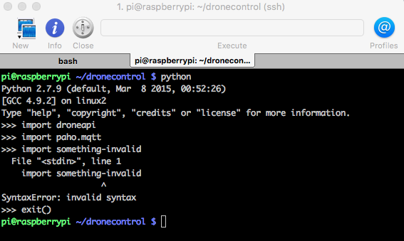

- On Raspberry Pi, Run the following commands:
cd ~ sudo apt-get install avahi-daemon sudo chown pi /usr/local/ -R sudo apt-get install nodejs npm -y sudo apt-get install zip sudo apt-get install screen pip install awscli pip install droneapi pip install paho-mqtt git clone https://veggiebenz@bitbucket.org/veggiebenz/echodronecontrol.git dronecontrol cd dronecontrol mkdir certsIf you have any trouble with any of those commands working (as in, there are errors in the command output), try the following and then pick up where you left off in the first code block above. You would need to retry any command that did not complete successfully.
#run these only if there were issues with the previous set of commands sudo apt-get remove python-pip easy-install pip hash -rTo validate that your python environment is now set up correctly, go into python command line interpreter and issue the commands “
import droneapi” and then “import paho.mqtt”. If these do not error out, you are OK. Enter “exit()” on a new line to leave the interpreter.

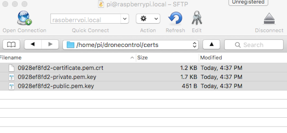

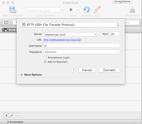

- Using an SFTP client (I am using Cyberduck for OSX), connect to Raspberry Pi. Click “Open connection” on top left, and fill out the information for your Raspberry Pi, and click Connect.
- In the SFTP client, navigate to /home/pi/dronecontrol/certs/ and upload the 3 certificate files from AWS IoT to the Raspberry Pi. Move these into dronecontrol/groundstation/awsCerts/. Take note of the file names because they will likely be different than what you see above, and you’ll need to put the file names into some of the program files later in the process.

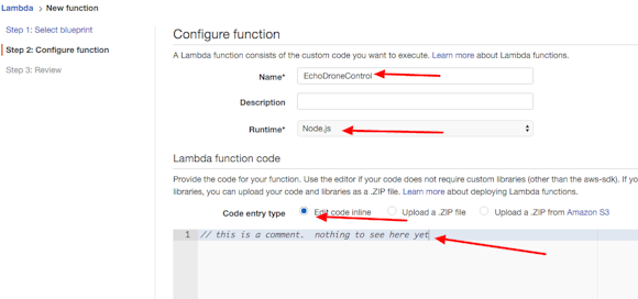

Setting up your Lambda function
- https://console.aws.amazon.com

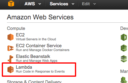

- Select “Lambda”

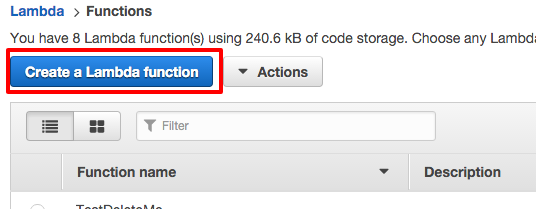

- Click on “Create a Lambda function”

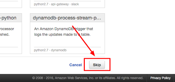

- Go down to the bottom of the page, and “Skip” selecting a blueprint.

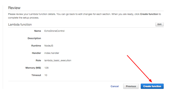

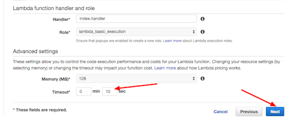

- Name your lambda function it “EchoDroneControl”. This is important because this name will have to match with a directory name on RPi for the upload script to work correctly. Leave runtime as Node.js, and select “Edit Code Inline” - we will actually upload our code using a script later. In the code block, just put a comment like:
// nothing here yet

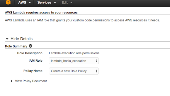

- Use Basic Execution Role, it will pop up a new window and suggest you create a new IAM role, it may suggest a name like lambda_basic_execution - this is fine. It doesn’t matter as long as you remember it as you will need the ROLE’s ARN later. You will have to enable Popups (disable popup blocker) to get to the Lambda Role page.
- Click “Allow” on bottom of Lambda Role page.
- Back to Create Function page, Leave other defaults except Timeout, increase to 10 seconds. Then click “Next”.
- “Create Function”.

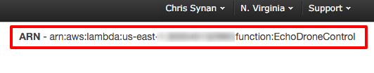

- Once your function page comes up, note your Lambda function’s ARN (Amazon Resource Name) on the top right. It will look like - arn:aws:lambda:us-east- etc etc etc… Copy this, because you will need to supply this to Alexa Skill configuration in a later step.

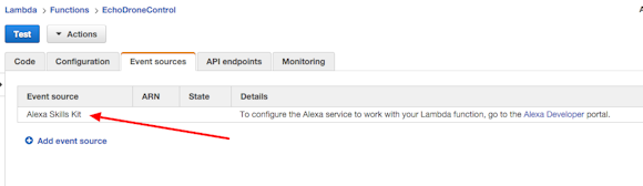

- Select “Event Sources” tab and “Add event source”. Select Amazon Skills Kit, and save.

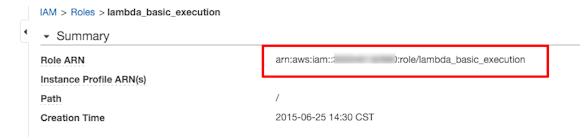

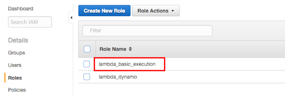

- Go to your IAM (Identity & Access Management) Roles page:https://console.aws.amazon.com/iam/home?region=us-east-1#roles
- Click on the Role you created a few steps ago- it’s probably lambda_basic_execution unless you entered a different value. Click it.
- Have a look at the top right of the screen, copy the Role ARN value.
- On Raspberry Pi, navigate to ~/dronecontrol/EchoDroneControl/ -- these are the files you will need for Lambda, and for Alexa Skills Kit (ASK).
- Edit “upload.sh” and paste the Role ARN value into the variable on Line 3. Without this you will not be able to upload the source code to Lambda.

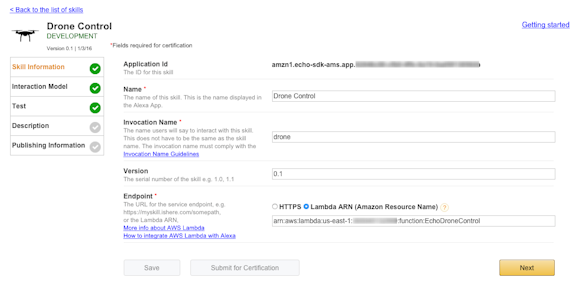

Setting up Alexa Voice Skill
- Go to https://developer.amazon.com/public/solutions/alexa/alexa-skills-kit to set up an account and create your skill.

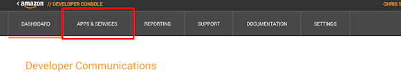

- Click “Apps & Services.

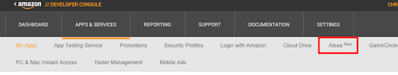

- Next, select “Alexa”.

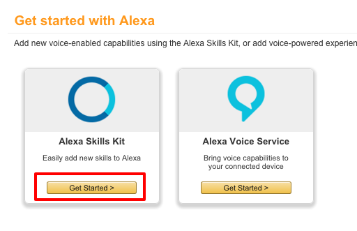

- Click “Get Started >” under Alexa Skills Kit
- Use name = “Drone Control”, invocation name = “Drone” and for Endpoint, select Lambda ARN and use the Lambda Function ARN value you got in the prior step (not the ROLE ARN).

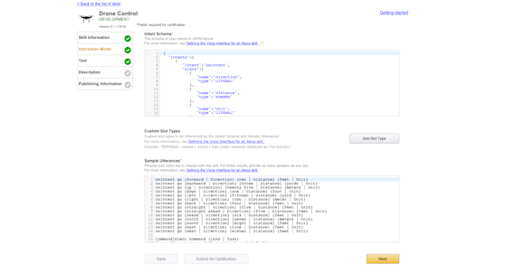

- Save these values, and next page you will see entry box for Intent Schema and Sample Utterances. We will get these from our GIT project.
- On RPi, navigate to ~/dronecontrol/EchoDroneControl/speechAssets/ -- these are the files you will need. Open up IntentSchema.json and paste the values into the Intent Schema box on the Amazon web page. Likewise for the SampleUtterances.txt, put the content in the corresponding text box on the web site, and select “Next”.
- You won’t be able to test this yet, so scoot down to the bottom of the page and click “Next”.
- On the next page there are some mandatory fields, so let’s fill them out.
- Example Phrases: “Alexa talk to Drone”, “Command Launch”, “Go forward 10 feet”
- It’s not necessary to submit for certification as right now it’s only you who will be using it. Be sure to save your entries though.

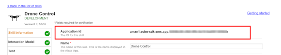

- Go back to the Skills Information on your Alexa skill, and now you should see an Application ID. This is what you will need to place in your lambda “config.js” page in the value for
app_id. The point of doing this is that someone else’s Alexa skill can’t execute your lambda function. The JS code will stop executing if it’s not coming from your Alexa skill.

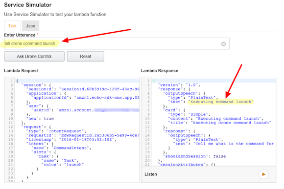

- Now that your config.js file is updated with the correct values, you can execute upload.sh to push the file to AWS.

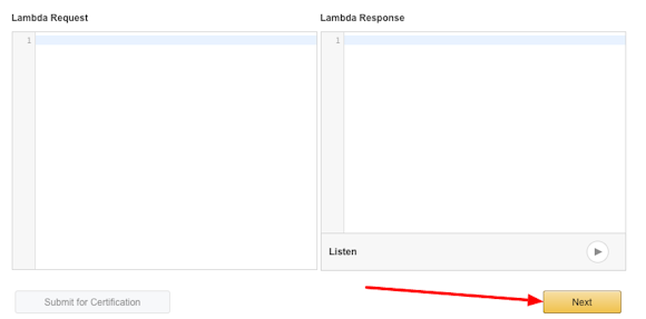

cd ~/dronecontrol/EchoDroneControl ./upload.shGo back to your Alexa Skill, and click “Test” on the left nav.
- Go down to “Enter Utterance” and type “Tell drone Command launch” and view the response from Lambda. You should see “Executing command launch” somewhere in the Lambda response. This means Alexa skill is talking successfully to Lambda.
- You should also be able to go into AWS IoT Logs and see the MQTT Connection and Publish successful messages.
