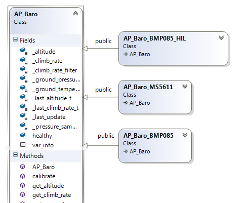

  • Harry has been using the class viewer but I recommend closing it while you are learning Class Diagrams. In my example you can see that I am using the Solution Explorer.
    The Solution Explorer is the best VS window for navigating a project but, by default, it does not include the Apm libraries.
    Below you can see that the ArduPlane project is selected in the Solution Explorer and that I have just clicked the menu item called "PROJECT>Show all arduino files". clicking the menu item instantly brings all of the Apm libraries into the current project (as shown below).
    With the Apm libraries in the project, it will be easier to use the solution explorer for diagrams, as demonstrated earlier.
  • After you have a diagram of the objects you are trying to understand you can re-arrange them using standard drag/drop.
    When you drag them around the screen you will see the connection lines becoming clearer and easier to understand
  • Plotting the entire project isn't the most useful but well done for working it out :)
    Another way to work is to CTRL+CLICK select the .h files you want to include in a diagram and then right click "Class Diagram"
    If you select source code that does not contain classes then Visual Studio will show the warning box Harry mentioned.
    Below you can see the Right Click menu and selection that was used to create the ClassDiagram24 of the pressure sensor system in Apm
