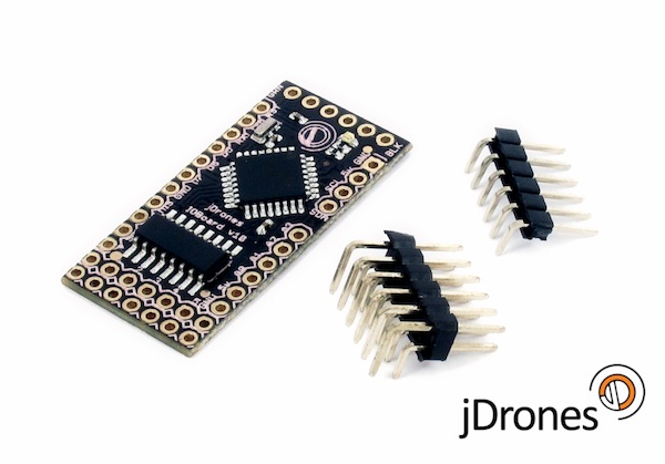

You had some problems on driving LED strips or something else?? Well no problems anymore.... We have seen people making all type of darlington/transistor and similar hacks to drive their LEDs, Sirens and so on but they all need a lot of hacking and they might not be suitable for long term solution.
We answered on this call and made fully Arduino compatible called jD-IOBoard that can run Single LEDs, LED Strips, Loudspeakers, Buzzers, Power switches and so on. It's upto your own imagination on what all you can control with this board.
jDrones_IOBoard_P2.jpg?width=500
So what does this board actually do?? It has fully Arduino compatible ATMEGA 328 MCU and Darlington array to driver high power outputs. Also I2C pins are exposed and same as many TTL level IO and Analog pins. As you can see from picture above.
Board has:
- 6 x High power outputs, max. 500mAh / 50 Volts
- 4 x Analog inputs (6 if you don't use I2C port)
- I2C port for controlling, listening I2C messages
- 6 x TTL level GPIO pins (8 if you don't use FTDI)
- 1 x FTDI port
3 high power outputs can also be controlled by PWM output while another 3 are just normal "On/Off" outputs

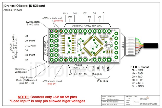

How those Arduino pinouts looks like:
jD_IOBoard_ArduinoPINs.jpg?width=500

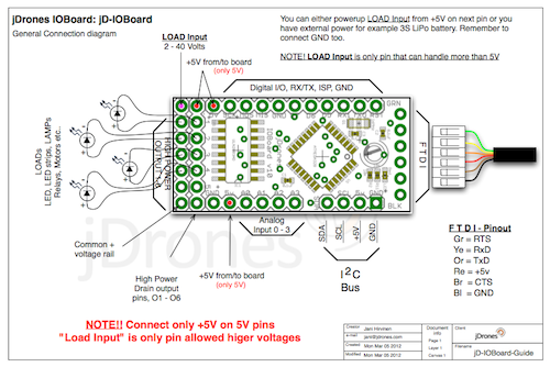

Connecting LED's,Buzzers etc is really simple. Just use one of output pins on end of the board. Below you can see examples on how to connect LEDs or LED Strips on it.
jD_IOBoard_GeneralConnection.png?width=500

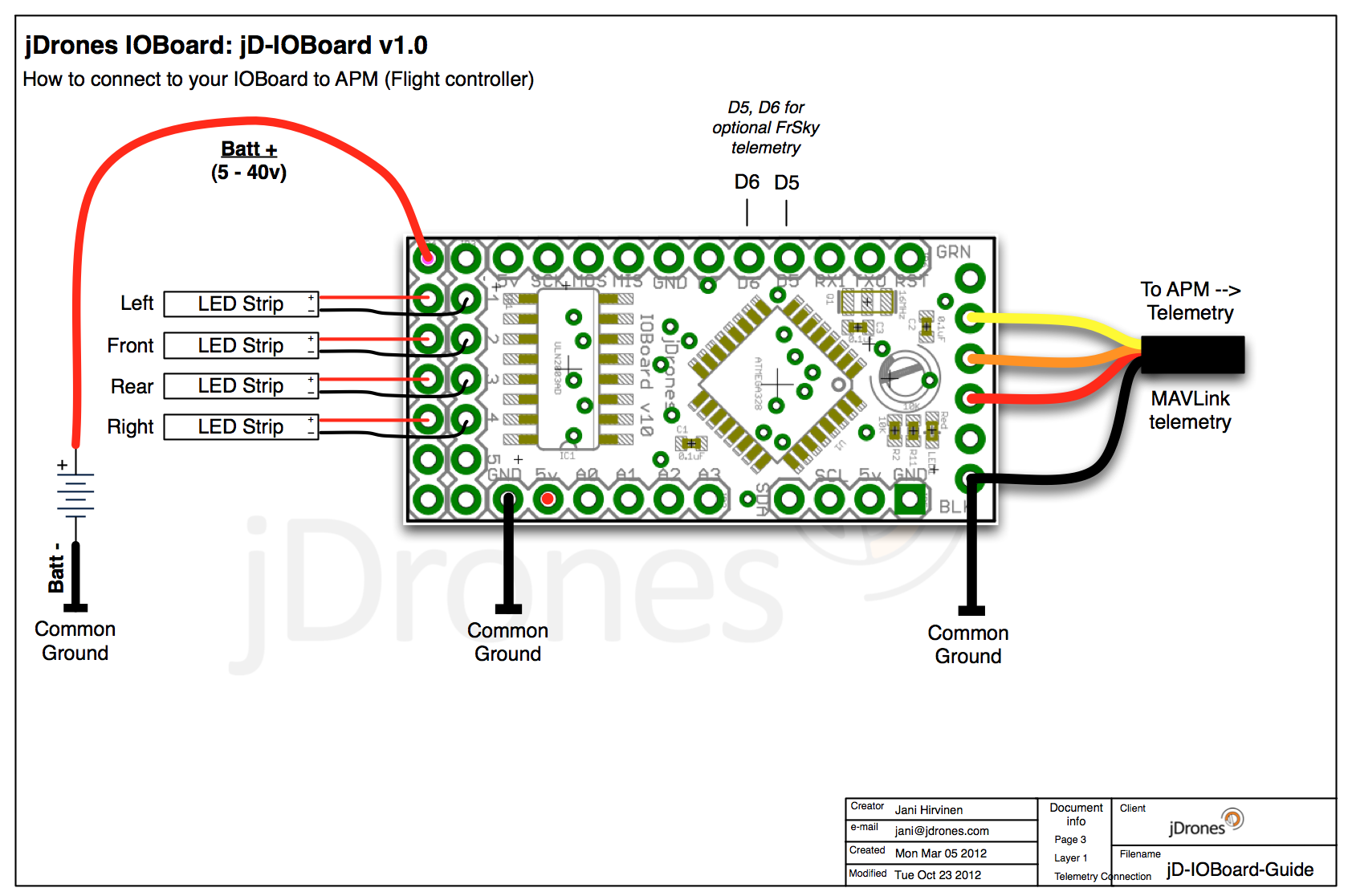

jD-IOBoard-TelemConnection.png?width=500

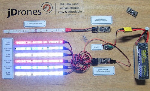

Pictures does not give enough credit for how it works so we made small video to show just few examples on how to use it. There are many other ways to do it but this should give at least some idea what/how to run it. So have fun watching it.

  • Mark, you have to program the io board using a FTDI cable with the pin sequence similiar to io board. u also have to usea arduino IDE program to compile and upload the program to the board. after programming u can connect it to telemetry port of APM1.
  • hi jani, thanx the LED strips are working now and the board seems to be fine. now just a dumb question, to upload the jdornes_mavlink.hex file can i use arduino IDE. do i connect Rx and Tx pins from APM telemetry port or just Tx pin to I2C port of i/o board.

    @Ravi, Go and get PWMFlasher from our repository and it will work without any I2C and others. PWMFlasher is same program as on the video we used on this blog post.
    Google Arducodes: PWMFlasher
