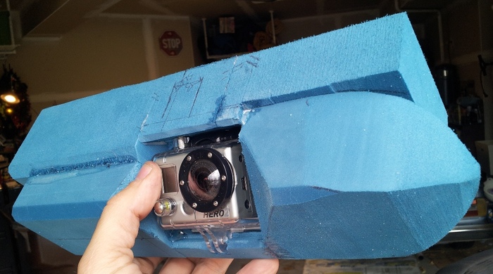

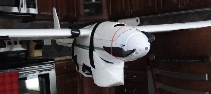

The early Smart-Pods looked like this - a solid block of high-impact EVA foam with cavities machined in to exactly fit the autopilot and other avionics that get housed inside.
The Smart-Pod is attached to the strongest areas of the host aircraft to create the rugged UAV.   It is shaped to be aerodynamic, and to serve as an effective landing sled to protect the instruments and the aircraft.

By separating the autopilot electronics and camera/sensor instruments from the hull/fuselage, and enclosing them in a container specifically designed to protect them, then the largest expense in fielding an UAV was also made the most safe and most durable.
By making the pod easy to add to any suitable aircraft available the plane actually becomes expendable, and even in the event of a complete catastrophic crash, could be replaced with a trip to the local well-supplied hobby store putting the mission back on track in a matter of hours.

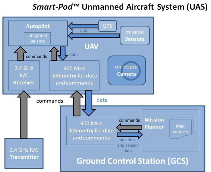

The GCS with the Mission Planner allow the UAV Pilot to visually plan the AUTOmated segment of their flight.  This is done in a point-and-click fashion placing waypoints (WPs) on a satellite map displayed in the Mission Planner.  The mission is uploaded to the UAV and assigned to a programmable switch on the DX7s Transmitter.  During the flight, the Pilot only has to press the switch to initiate the automated mission.   Here is an example of a trivial training mission with 3 WPs and Return To Launch where the UAV circles until the Pilot takes control and lands.
After the flight, the Mission Planner allows the Pilot to examine the Flight Data Log and chart the course as-flown in GoogleEarth. Here, the mission can be inspected to determine its accuracy and improve planning for future missions.

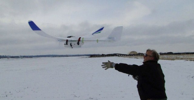

The launching and recovery of our UAVs has been made as easy and predictable as possible, and will allow the Pilot to focus on the purpose of their mission.

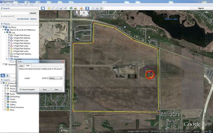

Below is a satellite photo of our testing grounds - all other images were captured from our UAVs at different altitudes over this test ground.  The RED and YELLOW circles illustrate the precision we are capable of - maintaining and repeating a circular path many times for close area surveillance.

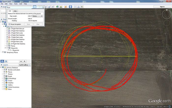

The above image... zoomed in with as-flown flight path overlaid.  .

For these images, the UAV was pointed into the prevailing 20 mph head wind and allowed to 'station' itself over a fixed point on the ground.  It can do this with or without the motor operating.

The Ground Control Station can be any of a variety of notebook PCs, brought to the field in a ruggedized Pelican case.  The GCS communicates with the UAV through the [XBee or non-XBee brand] 900 MHz transceivers.  All flight data is thus recorded on the GCS using the Mission Planner.  The Mission Planner is software running on the GCS.   Inside the Mission Planner the UAV pilot can see a satellite map or drawing of the area they plan to fly.  They plan a mission by placing Way Points on the map and assigning step by step actions to execute (such as 'loiter' around in a fixed diameter circle at a fixed height for a fixed period of time)  typically ending with Return to Launch place.
The Transmitter we prefer is the Spektrum DX7s or DX8.  This is the over-riding control between the UAV Pilot and the GCS/UAV.  The switches on the Transmitter will be pre-programmed, and allow the UAV Pilot to switch between Flight Modes.  With the flipping of a switch the UAV Pilot can make the UAV loiter or simply fly in a circle above his or her head (taking pictures).  With the flipping of another switch, the UAV will come home from wherever it is, and with the switching of another switch the UAV will execute a pre-planned mission, much like turning on a cruise control on a car.  When the pre-planned mission is complete, the UAV returns home, where the UAV Pilot can bring it in for landing.
The Smart-Pod makes the UAV much much easier to land than a normal R/C plane.  Most of our landings are "hands-off" with the autopilot stabilizing the UAV, all the propeller power off in a full glide, and the pilot only responsible to steer left and right.  The Smart-Pod provides a firm strong surface on which to land and protects the UAV from all but the most poorly executed landings.  We configure our UAVs to land themselves if a failsafe is triggered.
