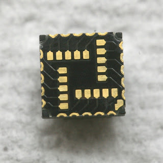

Marcy 2's camera is the 8 year old, famous TCM8230MD. Low volume options in this department are still limited to ancient parts.
Now that the undocumented footprints for the camera & Wifi are available for measuring, we can finally lay it out.
Sparkfun forums told a tale of various attempts to use the TCM8230. People have driven it with clockspeeds down to 12Mhz. They don't know if it can go lower. They get a framerate of 15fps when driving it at 12Mhz, but don't know if it can do full resolution at 15fps or only 1/2 resolution.
They don't know the output data rate with the 12Mhz clock & 320x240 video. They've used discrete logic to store the output in SRAM. 1 guy used an AL440B to buffer the data.
There's also the TCM8240MD, which has JPEG compression but is 8 years old. The hardware JPEG compression makes everything smaller. The thing is no-one's using the JPEG compression.
According to the Sparkfun forum, they're buying it for the JPEG compression but just using it for uncompressed. Neither do they know how fast the JPEG output needs to be captured. It could be 25Mhz, just like the uncompressed data. JPEG cameras are such an exception to the rule of what's sold, they're almost not worth it.
