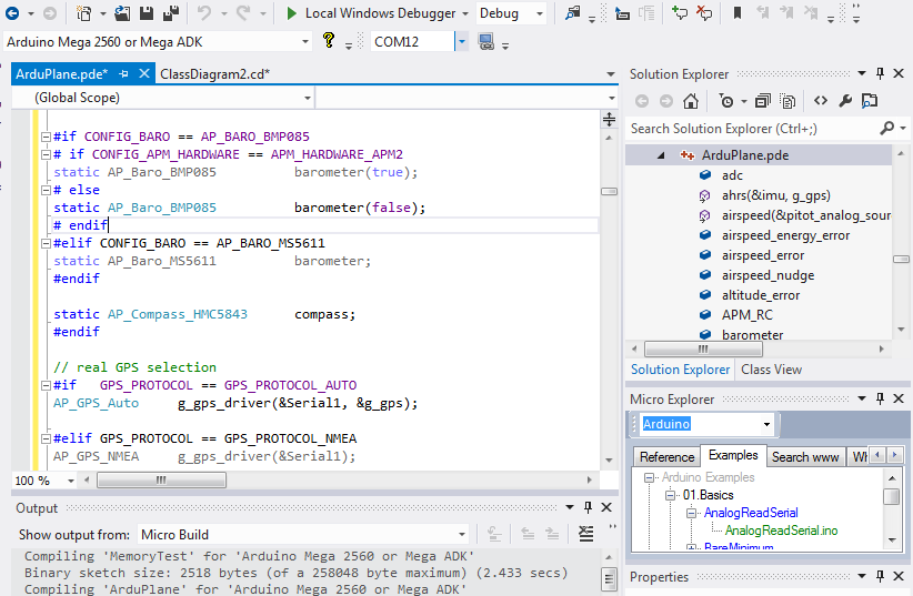

Click to see full size image of Arduino programming in Microsoft Visual Studio 2010.

Until now, developers who did not own a copy of Visual Studio have been able to use Atmel Studio for their Arduino/APM development (Atmel Studio is based on Visual Studio 2010).
Visual Studio 2013 brings a number of additional benefits over Atmel Studio such as great code visibility and powerful code explorers.

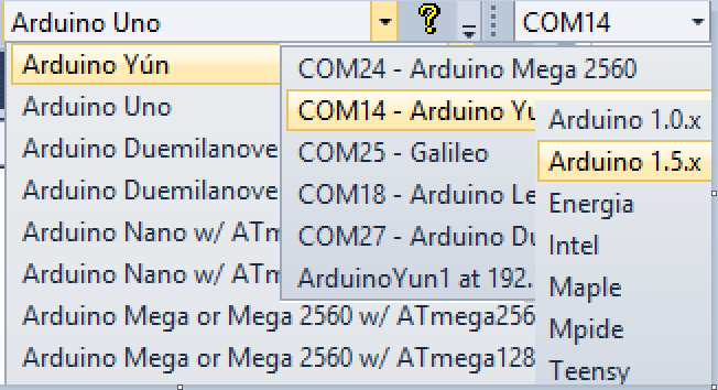

  • Hi Thomas,
    The plugin supports Intel, Texas Instruments, ChipKIT and Maple. I know some guys using it for Stm32 but i think they found a better core than Maple via the sparkfun site.
    The plugin also supports the Arduino 1.5 third party build process so can be adapted for various non-arduino hardware.
