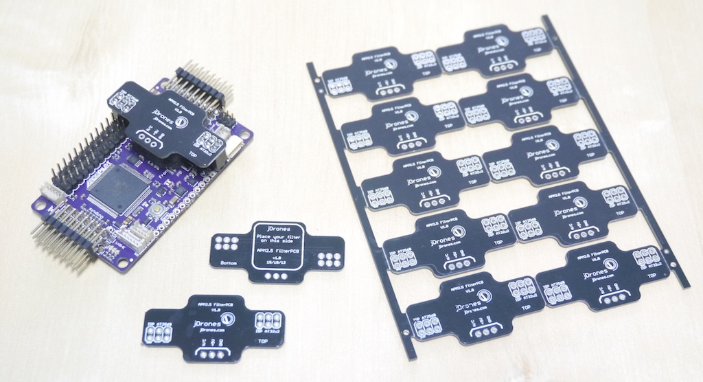

If your barometric sensor exposed on APM2.5?? Or you have tape/foam hack to cover it. Here is more elegant way to cover your baro nicely. On older APM2.0 baro sensor was covered with another PCB so it was not so exposed to wind blows and you got better altitude hold with it. On new APM2.5 board upper daughter board has been removed and barometric sensor is now fully exposed so it needs to be covered to avoid erroneous altitude readings.
We made custom APM2.5 Filter PCB for this purpose. It connects on both ISP pins on APM2.5 and foam on middle covers baro. There are additional +5V input provided on this board if you want to boost +5V system on your flight controller.
Ardupilot-Mega Wiki page has guide how to cover your baro but we were thinking that there has to be better ways than using tape and foam. Yes there are.

Filter PCB's are now available on jDrones store, 4.5 USD each. So grab one during your next order and you will get a lot more accurate altitude response from your APM2.5 boards.
Jani / jDrones

  • I can attest that getting the bvent holes int eh wrong place/too big on a rocket can be disastrous. But the basic point is to get to a point whether through foam or a bandaid (good idea, that) or a sealed chamber with a small hole, where any changes in pressure are gradual - essentially a physical low-pass filter for the air pressure. In the case of a plane, this should be easier since you can have the entire board enclosed and the airflow is more uniform. On a multi-rotor you get prop wash, wind, etc... on all sides, so it takes alittle more care.

    Correct you need to be careful with airflows. Especially when having really fast planes. Pressure difference can be big depending on your flight position.
  • Just a note; if the fuselage cavity is being "force fed" air( like through an open port on the frontal area), or experiencing a slight negative pressure( due to open holes experiencing a venturi effect), the airspeed of the craft and angle of attack can cause enough of a pressure difference, to offset the barometer, even several meters or so.
    Worst case? You dive the nose and increase airspeed, which could actually reduce pressure in the fuselage; the APM thinks it's going up, but it's not.

  • @ Jean B.  R-Lefebvre is on the right track . A simple project box to encase the APM will work very well; just vent it accordingly. You're just trying to "buffer" the air around the APM, so it's not affected by pressure differences caused by airflow around the fuselage- instead it's just reading true ambient static pressure, much like a static port on a pito tube.
