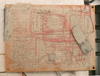

 Further progress requires starting to desolder the Heroine 2200 boards.  That was the 1st robot.  The ages from 25-30 were spent purely devoted to that 1 thing, while everyone else was clubbing & getting married.
Heroine 2200 would still be a working robot, with new electronics.   She was very unreliable with the old electronics, but modern vision systems & high bandwidth I/O could give her the accuracy to do the job.
