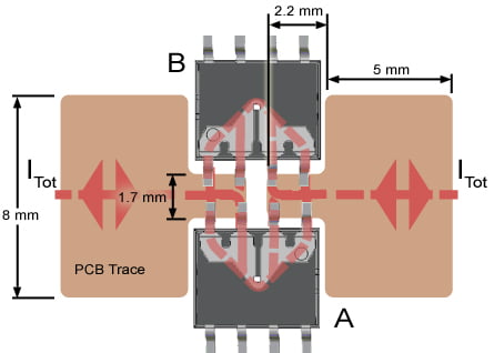

  • Warning, using attopilot with draw more than 180 can be dangerous because the power consumation grow wtih square of current :
    P = I² * R
    actual attopilot for 180A :
    180*180*0.00025 = 8.1 watts
    if you draw 272A
    272*272*0.00025 = 18.4 watts
