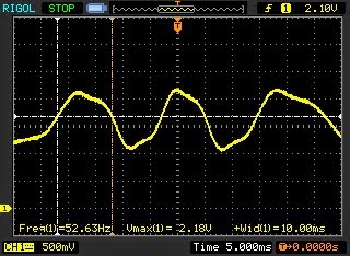

The home made buck converter was most efficient at 120Hz. It peaked at 9V 2.3A. To make that, it consumed 12V 2A for 82% efficiency.
The car needed 7.5V 1.5A. Lacking a real dummy load, it produced 7.5V 1.9A by consuming 12V 1.7A for 70% efficiency. The MOSFET still heated up over 75C. The efficiency was probably overstated because the load resistance was not accurately known.
The dropout voltage at nominal use was 3V. It was a much worse dropout voltage than an LM317. A pair of LM317's with a big heat sink would do the job in much less space. They have a 2.5V dropout voltage & heat to below 50C while providing 8V 1.7A.
A linear regulator would be 62% efficient. The circuit was definitely not the most ideal, probably owing to the MOSFET being extremely slow. A Castle 10A BEC could do a whole lot better in a lot less space, but this was the age of spare parts. Castle still required a $25 castle link programmer to get 7.5V. RC hobbyists are just not a market that reverse engineers electronics.
