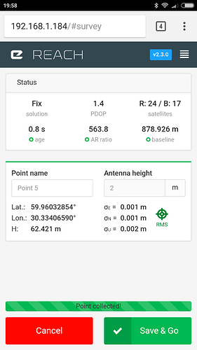

What makes this release so special is a handy point collection feature. Besides providing the main configuration funtion, ReachView v2.3 appears as a self-sufficient survey tool running on your RTK unit!
Screenshots of Survey Tool
Reach and Reach RS have been waiting for this feature. After few hours from the official announcement:
New Survey feature in ReachView provides:
  • Project-based point collection
  • Collection screen with a real-time progress indicator, RTK and averaging statuses
  • Collect the points either manually or with project-wide autosave rules
  • Project view with a map and summary point list
  • Export your data to DXF, GeoJSON, Esri shapefiles
All this is making ReachView a great assistant in the field. A set of Reach RS and a smartphone or tablet is all you need to conduct survey or collect Ground Control Points (i.e. before mapping with Drone Deploy)!

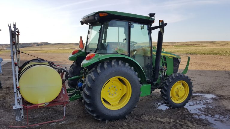

Reach RS for tractor gps guidance in the US (check it out)
