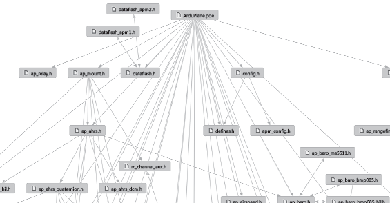

This WallChart.pdf is a first draft of an idea to provide diagrams of the relationships between the different modules of any Arduino drone project that new users can stick on the wall.
The pdf shows a map of how the various parts of the ArduPilot program interlink. You will see that currently the code diagram is very busy. How could all this information be presented in a more structured manner in a single snap-shot?

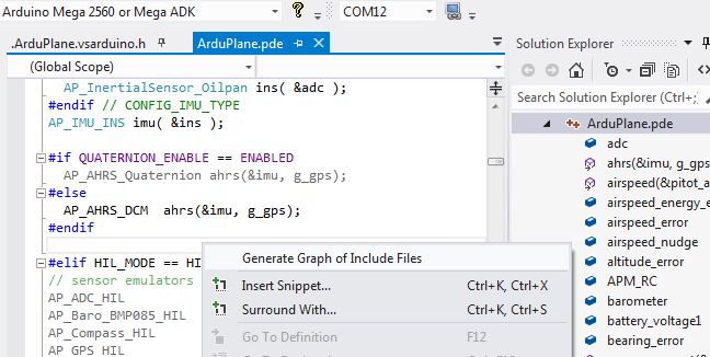

1. Open ArduPilot.pde or (.ino) in Visual Studio and right click anywhere in the code.

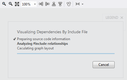

2. Visual Studio will open a new code window containing the diagram explorer tool. Progress will display while the code diagram is being automatically created.

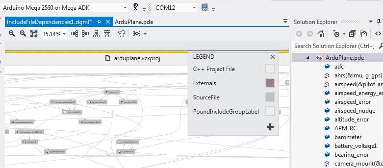

3. The code diagram will automatically appear when the visualization is complete. If required, you can edit the diagram, change the layout and remove items by using the mouse or diagram toolbar controls
