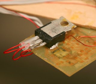

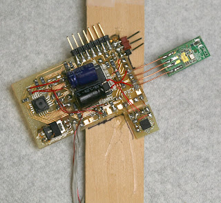

Bodge work continues, in the pursuit of supplying the required current in the smallest possible space.  The LM1117 was the only thing available locally.  It makes 3.25V at 800mA with a 1.3V dropout & no other components.  A single one wasn't enough.
The double stack still got hot enough to burn a human.  Meeting the size & weight requirements makes for some bleeding edge temperatures.
That ended up failing after a few minutes, leading back to the old TO-220.
It would be a lot cheaper to calculate the required current, voltage drop, thermal dissipation of the board, & get the exact right part.
Once you start pouring out heat to get the required power in the required space, the hot glue starts melting.  This has become disastrous in sunlight.  A hotter hot glue is required.

The lack of an ESC & no desire to break down Marcy 1 for her ESC led to implementing things which make Marcy 2 a product more than a science project, manely a full router stack.  ARP, ICMP, DHCP, & DNS were the big ones.  The mane dictator over all this is the high USB error rate, causing many packets to be lost.
DNS was a real painful implementation of a luxury.  It destroys the realtime performance.  It's too slow to ever be used, but a host name looks neater in a ping command than an address.
Marcy 2 takes your computer off the internet & puts you on her own isolated network in domain heroinewarrior.com.
The access point now supports 8 stations, with flight control possible from any IP address.  In the battle of the router, DNS was voted off the stack.  It worked, but was the only protocol which had response packet length determined by the user.  Some packet lengths caused yet another USB crash.  So DNS now sends a fixed size response.  If the domain name is too big, it's truncated.
Even without that crash, the URB_ERRORs make all the protocols unbearably slow.  ASSOC, DHCP, & ARP are pretty bad but only happen once.  The only way to make the experience fast enough is to limit communication to the flight protocol.  There's no way to have a web page for configuration.
The URB_ERRORs on the STM32F4 drop when the pipeline is kept busy.  In full operation, streaming 2 megabit video, there are almost no errors & the IP stack always works.  Another method is to poll the interrupt endpoint graciously provided by the RTL8192.  This always returns immediately.  The interrupts are absolutely useless, but they keep the pipeline busy enough to reduce the errors.
Sort of disappointing to go through all the trouble of supporting a USB dongle only to have it be incapable of basic IP protocols.  Since the USB core on the STM32F4 is a stock core from Synopsis, there's always hope it really works, but so far it still seems intended for a mass storage device, where the reads are always guaranteed to happen right after a write.

  • Jack, try Webench Designer by National (now TI) http://webench.ti.com?  Feed it your requirements and it prints out a schematic, bom, etc and you can simulate it.  It came up using a TLV62130 at 88% eff. for a 3S, smallest design, 3 resistors 3 caps (1 1206, others 0603), 1 inductor 2.2uH (about 1/4").
  • I'm with bGatti here, LDOs are simply the wrong way to get significant amounts of voltage regulated power.
    - LDOs in parallel basically doesn't work, they'll fight each other. That's probably what killed yours.
    Single-chip monolithic buck DC-DC converters are available all over the place, and they're not much more expensive than a pair of LM1117s either.

  • Marcy should get a buck mode voltage regulator.
    using a firestarter to change voltage levels is so arduino-class engineering.
