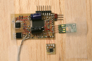

It's been ages since I ever removed the photoresist or actively tinned anything.  Tinning would definitely make it heavier.

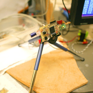

That is a heavy board.  The bottom of the camera faces the leading edge, so the scanlines cover a longer distance than a single frame.
This arrangement immediately caused the RF emissions to crash I2C.
Various attempts to defeat it failed.  Lower pullup resistors on I2c, routing the I2C away from the wifi, moving the wifi away from the motherboard didn't work.  It's just going to be limited to 40 samples/sec by the RF.  The same thing happened on Vika 1 with the XBee.
Marcy 1 needed 112 samples/sec & got that with a long I2C cable, but a very low power radio.  Cell phones must have a lot of shielding between their I2C sensors & the RF.  The AR drone has the Wifi on the opposite side as the analog sensors.

  • I2C is seriously fragile in the first place, it's got no inherent protection against EMI.
    One thing that might help is to twist SDA and SCL with 0V, but probably not enough for that kind of length.
    - Twisting SDA and SCL together does nothing at all except make the wiring look neater.
    Level-shifting to a higher voltage along the wire may also help if you can get the threshold voltages far enough apart for the noise level.
    However, the real problem is the distance. I2C was never intended to be used like this so you should try to get the master and slave closer together by any means necessary.
    In cellphones I2C lines are a couple of cm long at the maximum, less if they can manage it.
