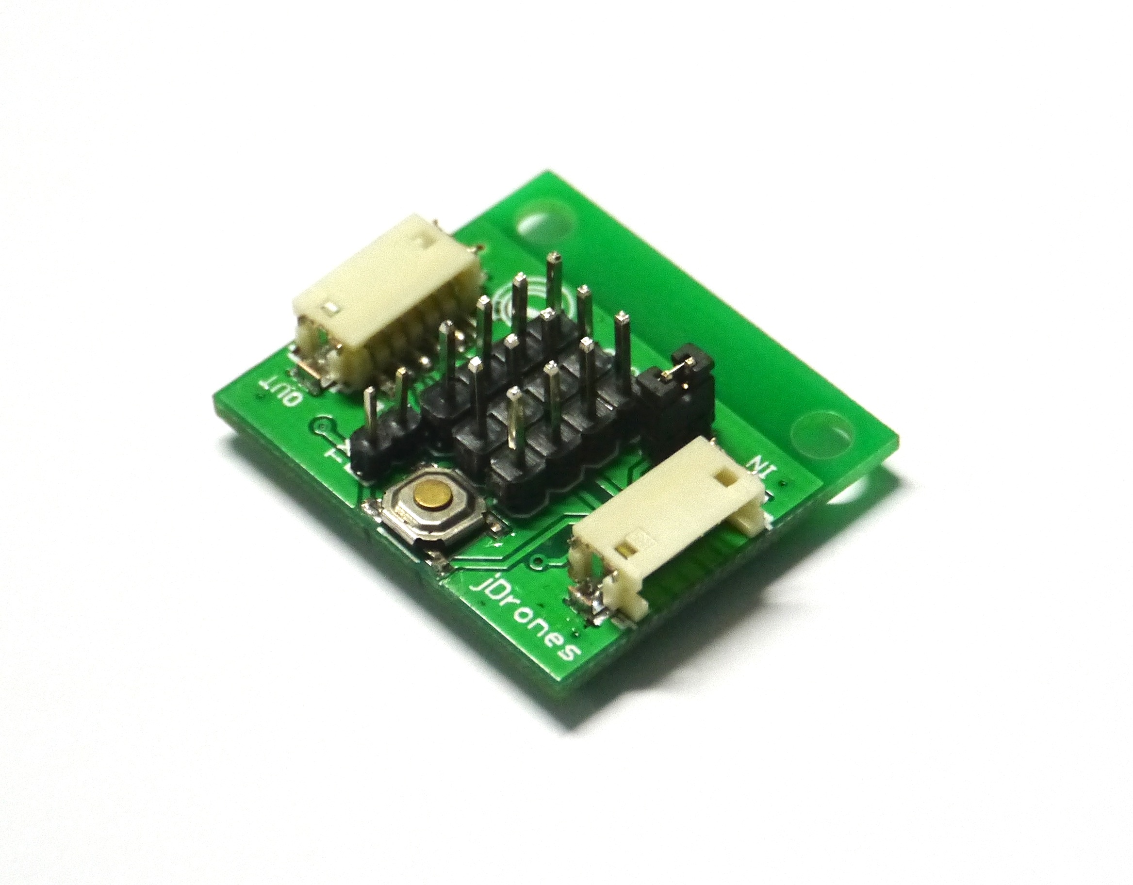

These small little telemetry expanders will be available in jDrones on beginning of next year.
They are fully assembled and fits on APM2.5 cables + generic cables.
Normal telemetry is passtrough and then IOBoard/OSD and other secondary devices connects on vertical pins, If you don't have telemetry you can start MAVLink requests by pressing the small button or just to have jumper to permanently allow those requests to flow.

Christian, yes that is normal way how MAVLink works. Same with OSD. If you don't have telemetry you need to connect Rx signal wire too so OSD/IOBoard can request proper update rates from MAVLink. If you do not request those update rates, MAVLink does not "speak" needed values and this case it would only send heartbeat data but that's about it.
That's why we made this board that helps you to connect IOBoard, Telemetry and OSD as all or as single units.
