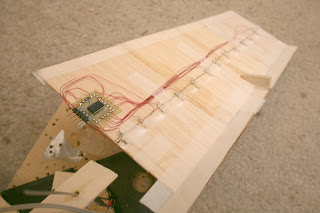

The 2nd Marcy 1 took to the air. This one is loaded down with the POV LEDs.
Visually the same, but mostly redesigned. The POV processor & mane processor now read the radio directly instead of the mane processor passing on data to the POV processor. It was 1 more wire but much simpler code. Even though it was built in July, this was the 1st time this airframe did POV. The motor is immediately getting too hot, melting through the propeller.

There was supposed to be a 3rd Marcy 1, with an onboard camera. It's possible to get a very small, wireless camera, but the only fabrication possible in the apartment is a large wireless camera.
