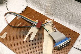

The best way to program an ARM without buying a programmer is  Openocd
After banging on openocd for 2 days, trying to get it to work with the home made USB bit banger, we soldered a quick parport adaptor & it worked immediately.
The parport was faster than our USB bit banger & it worked.  Really wished the USB bit banger worked, since nothing on the bench still has a parallel port.
2 more days of hacking yielded a functioning USB JTAG interface.  The trick was level conversion using 120ohm resistors instead of 1k.  Also, the SDO pin needed a BJT level conversion.
Building Openocd was a matter of
configure --enable-dummy --enable-parport
then copying src/jtag/drivers/parport.c to src/jtag/drivers/marcy2.c
Edit marcy2.c to use the USB bit banger, then add marcy2.o under every parport.o in the Makefile.  Compile it with errors, then link it manually.
gcc -o openocd main.o ./.libs/libopenocd.a ../jimtcl/libjim.a -ldl /amazon/root/vicacopter/libusb-1.0.0/libusb/.libs/libusb-1.0.a  -lpthread -lrt
Run it with
openocd -f script
where script is a file in the current directory.  So far, our script has:

For a new board, you need a script which just says
interface marcy2
adapter_khz 30
jtag_nsrst_delay 100
jtag_ntrst_delay 100
That causes it to probe for the TAPs & generate the jtag newtap commands, but it doesn't get the target running.

The next great task is programming the flash.  The only way to send debugging commands after openocd is initialized is
telnet localhost 4444
Key commands:
poll
reset run
reset halt
flash write_image erase /amazon/root/vicacopter/arm/copter.bin 0x8000000
That's very slow.  The USB bit banger is limited to the extremely slow 4000Hz.

So after 5 years, our 1st toggling GPIO via home made ARM board came to life.  Programming it over the home made bit banger is too slow.  The CPU clock isn't running at the full 168Mhz.
