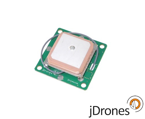

Model One: is specially made for ArduCopter / Multicopter use and it has detachable high patch antenna with 10cm cable so if you want you can always detach antenna from main module and put it on big groundplane.
Top side of ArduCopter / Multicopter GPS
jDrones_uBlox_NEO6_P1_0769.JPG?width=500
Bottom side of GPS with antenna detached:
Technical detail:
  • PCB size 38 x 38 mm
  • Mounting holes 32 x 32 mm, M3
  • EM406 style connector
  • 28 x 28mm detachable high gain antenna
  • Battery backup
  • I2C bakcup memory
