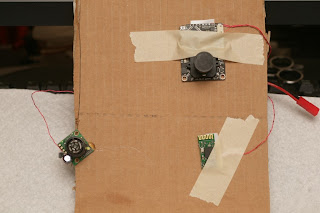

Sonar, PX4flow, flight computer, & bluetooth are soldered in the navigation test harness.

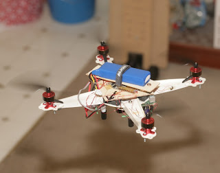

The Turnigy Microquad has the highest capacity for its size.

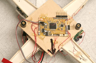

It's single sided PC boards, conventionally routed.  No 3D printing, laser cutting, or anything else.

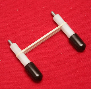

 The landing gear is made out of PC board standoffs.
The motor mounts need a lot more reinforcement.  Some guys glue on carbon fiber or plywood doublers.
It has enough clearance for the PX4flow.  The battery needs to go on top, over the mane board.
Taking a page from the AR Drone, the battery is used to weigh down the IMU.
It's the most energetic platform so far, definitely not a toy.  Those Turnigy 1811-2900's get a lot more thrust from the same space as brushed motors.

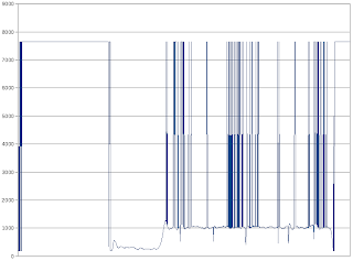

For the 1st time, you can see just how many sonar readings are invalid.  It generates 7650 when it knows the reading is invalid, but sometimes it errors low.  It never seems to error high.
The object of the game is to fuse the air pressure & sonar readings to eliminate the errors.  Sonar still has to be the master.
