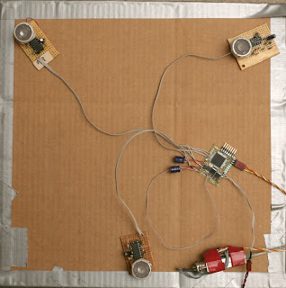

Completion of the next sonar board using 168Mhz ARM revealed some interesting nuggets about the STM32.
It works with only 1 VCAP, VDD, & VSS connected, greatly simplifying the routing.  The VDDA & VREF+ can be connected to a VDD pin.  Only 1 VSS is required.
ADC sampling can go in the 600khz range with no obvious noise issues like the PIC.  8 bit sampling goes a lot faster than 12 bit.  While it can do a lot more with audio than video, it's still very limited in the 300khz range that you need for sonar, so you'll be hand optimizing.
Function calls kill it.  As much as possible must be inlined.  Those convenient GetFlagStatus calls need to be replaced with inline ->SR calls.
Some operations go a lot faster with unsigned than signed variables.  1 operation that signing killed involved multiply & divide.
The packing order of variables affects speed.  Splitting up a bunch of frequently used variables with large, infrequently used buffers slows it way down.  Having all the frequently used variables together speeds it up.  It's a caching issue.
So with the ARM screaming at 329khz per channel, that was propagation delay with the sensors 3" apart & the transmitters 2ft away, on the bench.
That was the propagation delay over 10 ft with 3 sensors.  That actually looks equivalent to the PIC sampling at 266khz.  1 of the sensors has 4x the gain of the other 2, without showing any obvious difference.
The position calculation in centimeters once again lost a lot of precision.  With the 12V emitter & super fast sampling, it was almost omnidirectional, but the precision dropped as the horizontal distance increased.  This was the 1st time horizontal accuracy was seen improving dramatically with wider sensor spacing.
The pings were 8 Hz.  The sampling rate was 329khz at 8 bits.  There's no point to using the 256khz radio bandwidth.
Calculating the position has been done with very slow, trial & error pythagorean calculations on the ARM.   Despite its floating point support, there hasn't been enough incentive to load the math library on the flash, to do a fast trig solution.
The position is only calculated on the ARM in case it could be sold as a standalone position calculator.
