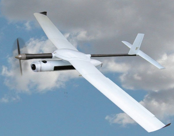

    Great discussion. We once made our own skylark variant.3692501751?profile=original

  • An airbag!  The "I want" feature that every UAV dreams of.
    It is not going to work for me but I would very much like to see yours working.
    @Matthew, you should google the skylark II landing videos... VERY COOL, I'll post one when I get home from work.
  • @Brian, That is one of the more elegant UAVs around.  I like it.  Landings are going to be interesting with that bomb hung underneath.  The first thing I thought for building that pod was a plastic coke bottle.

    @Matthew, the plane I posted is called the "Skylark II" by Elbit Systems.  I'm making my version, called the "Meadowlark " of the plane using square carbon tube and an old Aerobird Extreme main wing (tail will be scratch balsa).  The pod I'm planning is a simple radio shack project box.  Hopefully I can find one that is only about 2.5w x 2.5h x 8-10 (what ever is big enough to hold my electronics (or most) and the battery.  The system for holding the main wing to the fuse will be molded cf/fg, conforming to the wing shape on top and gently down to the boom.  This piece will clamp the wing and boom into position and allow for adjustment of cg/payload.  This mount will serve as a secondary place for electronics. No picks yet, but here's another shot of the Skylark II.
    skylark2_2.jpg?width=350
