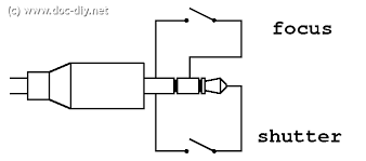

andresiko replied to andresiko's discussion trigger a camera shorting 2 wires via pixhawk
"Solved*******
kinda temporary solution; using the electronic switch that i had hanging around, hacking it a little (I soldered the "line in" to the "aux" in order to have an 5V output when switching on via RC), and powering the relay with those 5V…"
May 22, 2017
"@Asim
My pixhawk is already connected to servos and BEC, (its on a plane with many flights) servos are only connected to the "main out" not to the "AUX out", but I also tried with 1 servo connected to "aux out" (in order to create a "load") and I…"
May 22, 2017
"found it, my fault, as expected!
the Voltage went only to 0.5 because the relay was connected, and did not receive enough intensity to activate =/.
Proper relay shipped, will report back as soon as it arrives.
Thank you from a city much better…"
May 22, 2017
"I may have not explained myself, or I'm not understanding your point. When not triggering photos there is 0.0V between "-" and "signal". When triggering the photo (set to 2.5s duration) this voltage goes up to 0.5 for those 2.5s."
May 22, 2017
"it's been a while configuring the mission planner, and testing with the multimeter (did not connect the relay nor the camera) and the output voltage measured is only 0.5V. I've to say that this voltage is totally unexpected!
I assume that the…"
May 22, 2017
"Hello again, and thank you a lot for your help!
dont worry about any responsibility, I am the guilty if anything goers wrong xD
Just came back from the electronic store near my home, bought arelay for 3$, Is for "dual channel" but will be using only…"
May 22, 2017
"Hello Asim,
I am quite messed up with that link, dont really know where to plug what!
Lets assume that my ground cable is black, and the "trigger" cable is red, and red cable is 3.1V. When I short them the camera shots a photo. Where shall I plug…"
May 22, 2017
andresiko posted a discussion
Hello all,I want to trigger my camera shorting 2 wires (soldered to the shutter button of a nex7), and I'm quite lost. Any advice? do I need any extra device or can i just plug it to a pixhawk output port? How to connect?The camera trigger is 3.1V,…
May 21, 2017
