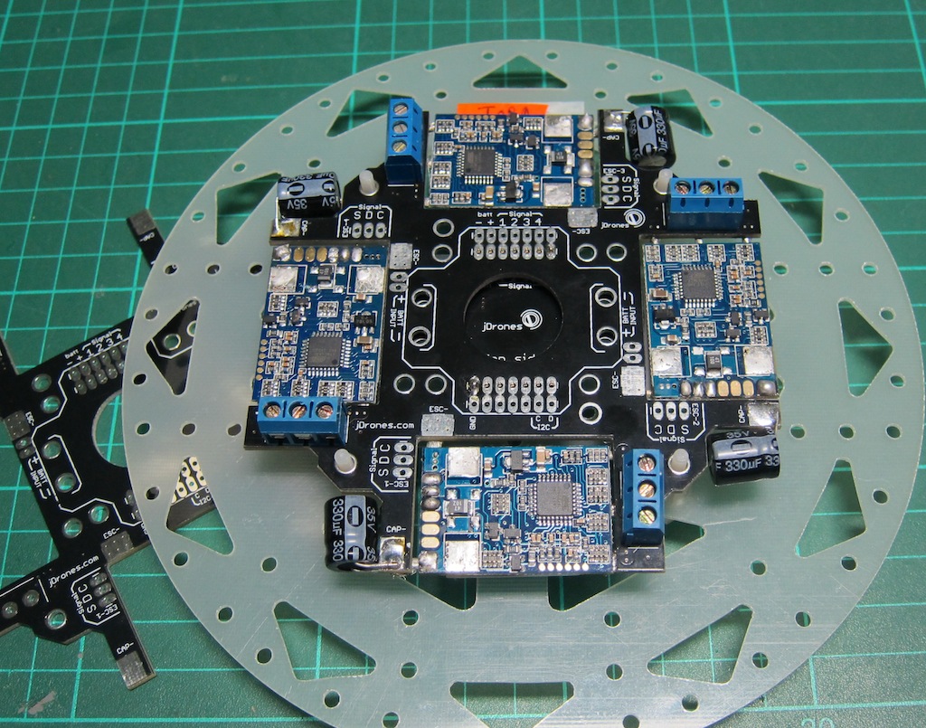

I think the development of the opensource ESC system needs to have in consideration this kind of modular integration in the design of the boards
jbabio, we already have board that allows you easily to change ESCs if they are getting defective. Our goals are to create an ESC that can fit on common size of 25 x 37mm. Most of ESC are on that size and they will all fit on this PDB board.![jDrones_4ESC_PowerDistribution_Top_0223_sml.JPG?width=500](http://www.jdrones.com/media/parts/pdb/jDrones_4ESC_PowerDistribution_Top_0223_sml.JPG?width=500)
I Vote for the circular design for power distribution, servo inputs and motor connections for wiring simplicity with shield-type ESC mounted, this way changing a defective ESC will be quite straight forward and easy to perform on the field.
Also, the modular design allows you to use the same "Motherboard" for the different multicopter configurations (tri, quad, hexa, octo) so you can start with a small tricopter and purchase more "ESC shields" and motors as you progress (or afford for them)
I think that mounting the ESCs in the centre is better despite below the props they get cooler because of the lost of efficiency and stability due to turbulence. I've mounted the ESCs on the central plate of my heavy octo (CarbonCore Octo 1000) and have no heat problems at all (Himodel Pro 40A + T-motor MT3515-15 400KV) and the arms are completely clean because I run the cable inside them.
Just my 2 cents.

I would stay away from multiple ESCs on a single PCB. As ESCs tend to be a common failure point (due to the electrical stresses on the components, even when well engineered), I would like to avoid junking three good ESCs because one failed of a quad set. I am assuming SMT technology where the cost of a repair would exceed the cost of a replacement.
