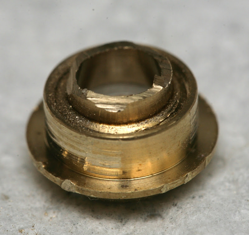

Finally, from goo tube wide angle lens lore, we have the peephole.
It has 2 lens elements. It splits in 2.
revealing a useless image.
The front element can be ground off.
