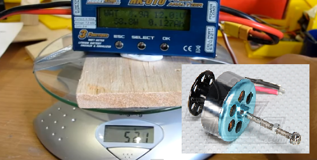

Cobbled together 90 mm fan with 250 Watt  Turnigy L2210-1650 Bell Style Motor (250w) seeing if I can get decent efficiency from a small fan turning slower.
On 14.8 Volts its pushing almost 500 Grams, not so bad thrust mapping is as follows.
100 Grams 1.9 A 27.6 Watts
156 Grams 3.0 A 42.9 Watts
197 Grams 3.9 A 55.1 Watts
257 Grams 5.5 A 76.0 Watts
296 Grams 6.7 A 90.9 Watts
340 Grams 7.9 A 105.5 Watts
432 Grams 10.7 A 138.1 Watts
492 Grams 12.5 A 155.7 Watts
The data in a spread sheet
The tests were run on two 7.4V 1300mAh Turnigy 20C Lipo's in series, I figure the motor will survive full throttle bursts on 4C and its 10 Amps short of the max, 100 Watts below its spec.
Its surprising as the same motor with a 8 X 6 prop pulled 23.3 Amps on a 3C yielding 520 Grams of thrust at 232.3 Watts.

Better trust then the 100 Amp ESC withe the Dlux
Test setup 2200mAh 3C 20C Lipoly DT850 motor 11 X 4.7 Pusher Prop
Rpm/V: 850kv
Max Watts: 380W
Max Amps: 35A
Max Volt: 7.4~14.8v (2~4S)
Idle Current: 1.5A
Resistance: 0.039 ohms
Weight: 107.1g
Shaft: 4mm x 39mm threaded
Can Size: 41mm
Mount Diameter: 30mm
Spec.
Max Cont. Current: 30A
Max Burst Current: 40A
Max BEC Current: 2A
BEC Voltage: 5.5v
LiPo: 2~4S
Weight: 23grams
Max RPM (2-pole): 200,000rpm
Size: 51 x 27 x 11mm
Motor Plug: Female 3.5mm bullet Connector
Specification:
Working voltage range: 0-60V
Working current range: 0-100A
Power: 0-6000W
Cell count: 1-6S
Battery type: LiPo/LiFe/LiIon
Weight: 140g
Dimensions: 103x49.5x20mm
Working temperature range: -20~50°C
